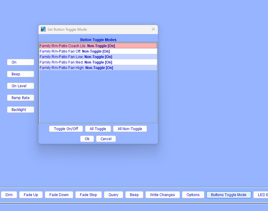

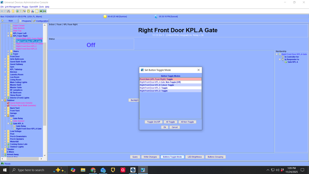

Configure the KPL as a non-toggle on. You do this from the main screen of the admin console.

Now, every time you click the KPL button, it will send a "control on" Insteon command. This will trigger the program and turn the relay on for 3 seconds (or whatever you put in the program). The backlight on the button will end up being on all the time, which may be fine for you or maybe not. If you want the backlight to change depending on something, you would have to be more specific on what you are looking for. I suppose if you wanted the backlight to default to off, you could set it to non-toggle off and change your program from "switched on" to "switched off".

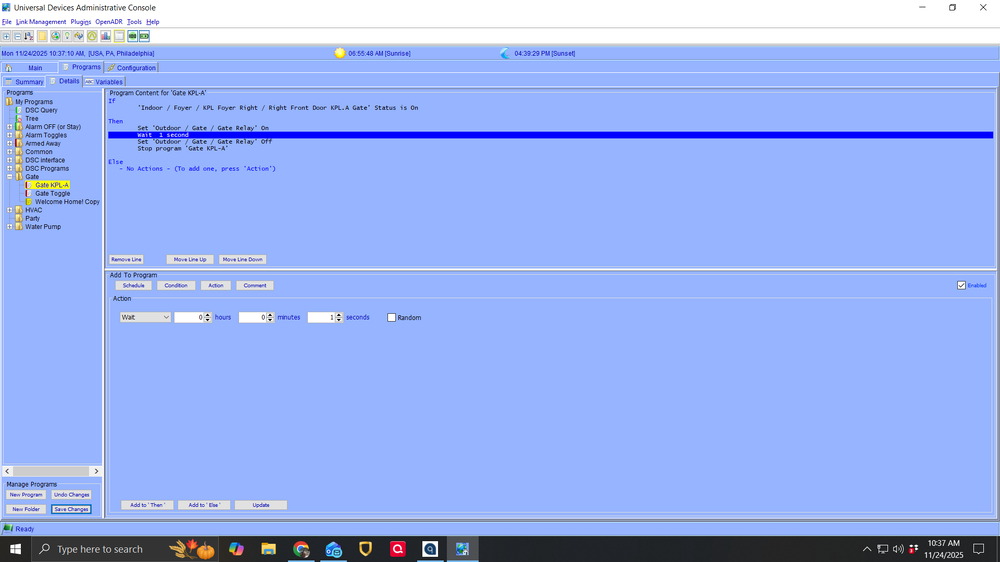

Thanks I tried copy to clipboard but it only shows text:
Gate KPL-A - [ID 0002][Parent 006C]
If
'Indoor / Foyer / KPL Foyer Right / Right Front Door KPL.A Gate' is switched Off
Then
Set 'Outdoor / Gate / Gate Relay' On
Wait 1 second
Set 'Outdoor / Gate / Gate Relay' Off
Else
But is this what you meant for me to program if I always want the backlight off?
@mitch236 Yes. What you have there should work. Every press of the button will send a "control off" which is the one and only thing that can trigger the program (as opposed to a "status" program that triggers on every change in status) and it will only ever run "true" with that as the only item in the "if" clause.
I don't recall ever using "non toggle off" before, but I would assume that this would turn the backlight off with every press. And if there is no other program or scene that turns it on, it should never be on. Maybe after a power cycle perhaps? I don't think so thought, usually they come back up as they were when power went out.
