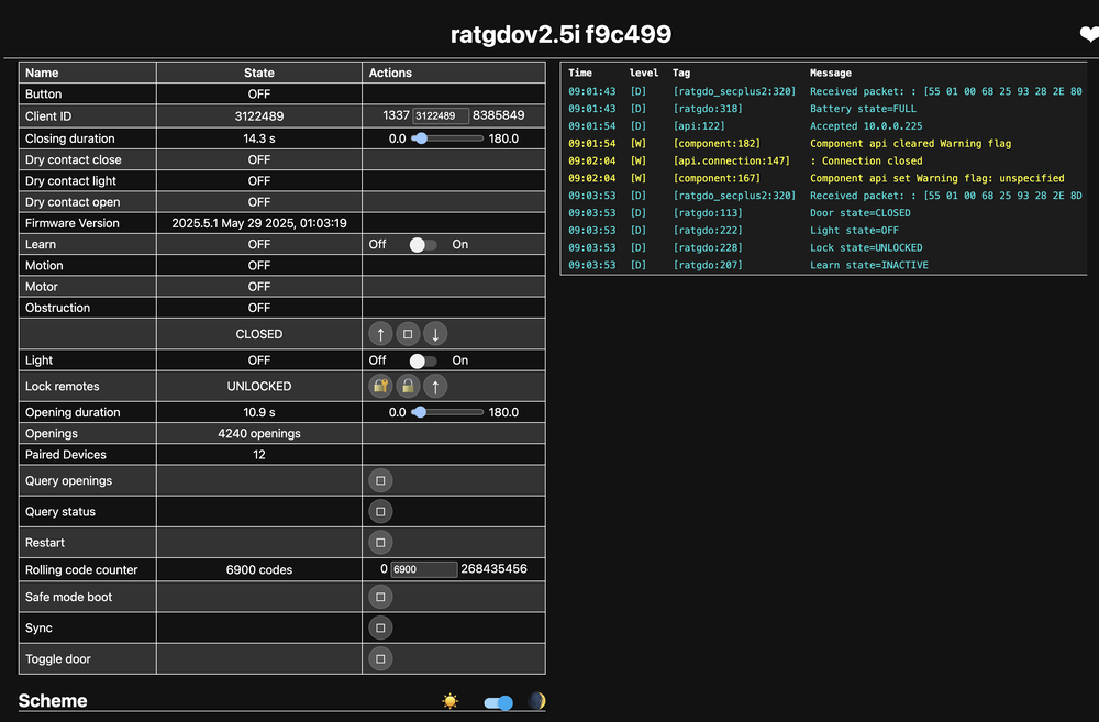

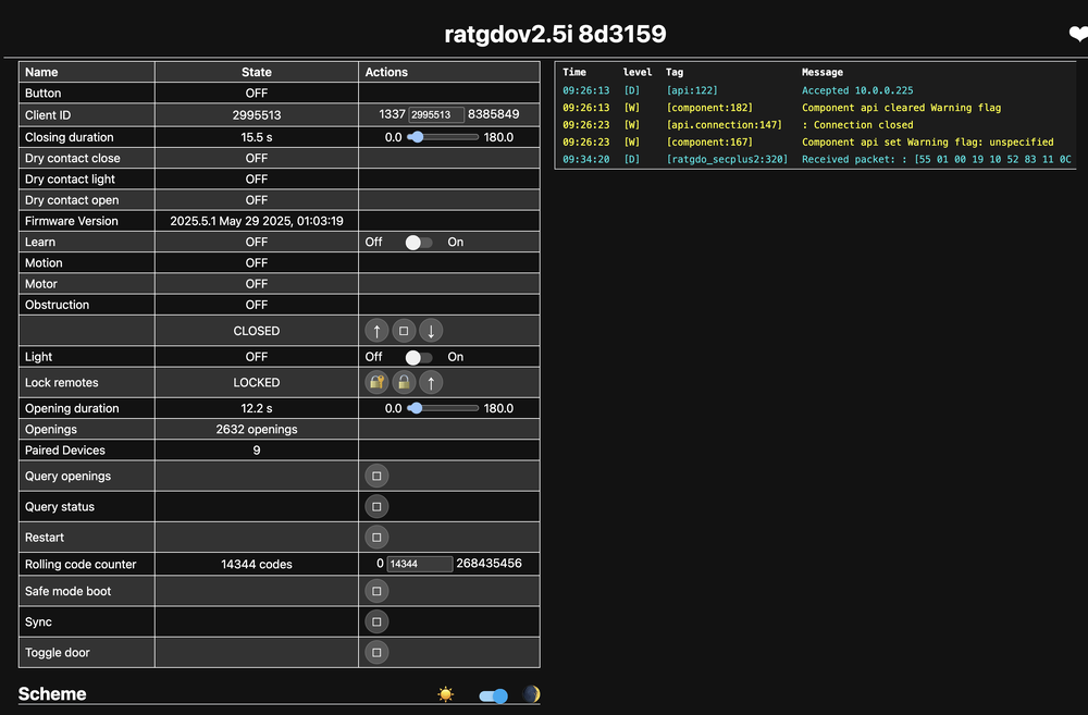

January 18Jan 18 Have been using ratgdo devices (ESPHome firmware) on 3 Liftmaster 8550 garage door openers with 880LM wall openers for some time without any issues. Recently, 2 of the doors will spontaneously lockout the remotes, and even if I disable the remote lockout in the 880 LM, the lockout mode will re-appear within a few hours. I did change out one of the 880LM wall openers but problem persists. The Liftmaster/Chamberlain support staff are clueless. Attached are the ratgdo logs for 2 garage doors, one which is not experiencing the lockout ("...C499") and the other door that is ("...3159"). Any ideas?
