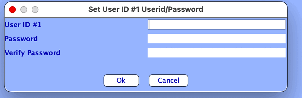

May 9May 9 I want to create a second user for the Eisy, with limited rights/privilege . The uploaded screen shot appears to allow creating additional users, but when I try to login with new credentials if fails. So, is there another place I need to go to enable the user slot?
May 11May 11 On 5/9/2026 at 7:42 PM, Michaelco said:I want to create a second user for the Eisy, with limited rights/privilege . The uploaded screen shot appears to allow creating additional users, but when I try to login with new credentials if fails. So, is there another place I need to go to enable the user slot?I'm not sure for what app you are trying to reduce rights.But what I know is there is 2 sets of credentials, and you are probably confusing both.The screen shot above allows to create IoX local users. We are going away from this in favor of ISY Portal credentials. So if you are logging in with an email address, that is an ISY Portal username.To create additional portal user, go to my.isy.io, login, and click on the Users tab. Then you can add a user there.
