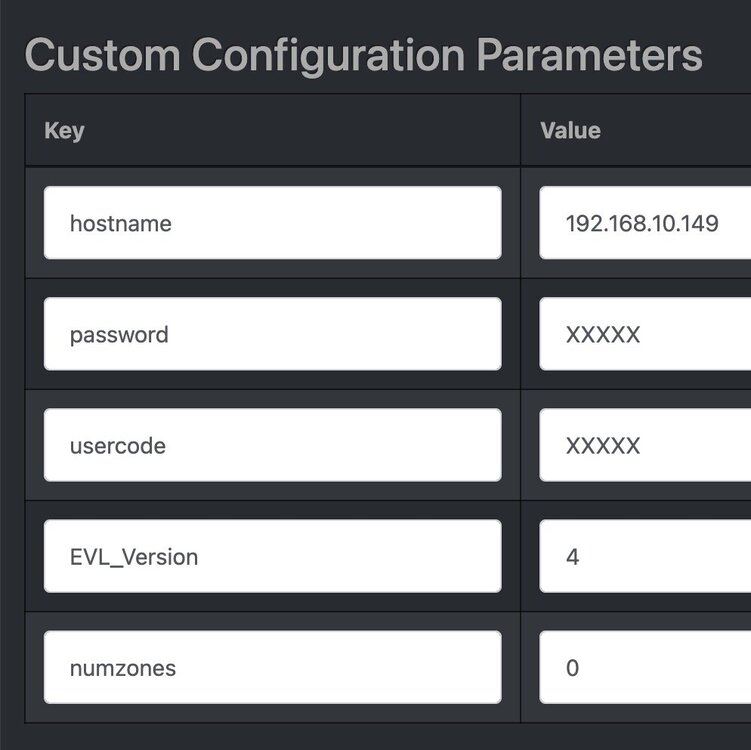

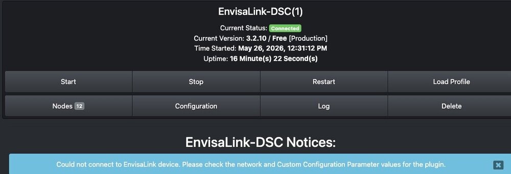

May 26May 26 Used the EnvisaLInk 3 with my Honeywell system and the EnvisaLink-HW flawless for over 2 years.Moved last month, alarm is now DSC Neo, so purchased the EnvisaLInk 4MAX with the UNO4 Zone Expander (needed for EyezOn to communicate with the DSC Neo).Now when I installed the EnvisaLink-DSC on my PG3x (version 3.4.18), it shows the plugin cannot connect to the EnvisaLInk device and to check the network and Custom Configuration.My network doesn't appear to be the issue, as I can open the EnvisaLink web page (192.168.10.149), so I'm assuming I must have missed something with the configration.I tried leaving the zones at the default of 8, but according to EyezOn, it won't report zones on the DSC Neo so I then tried with 0 as the setting, still no success.

May 28May 28 Author Great questions. There is very limited control with the EnvisaLink 4 Max with the DSC Neo. It basically can only arm and disarm the system. No zone monitoring, so that is why I switched the zones to zero, hoping that would fix the communication issue. The expansion board, UN04 allows DSC Neo to send an alarmed condition back to EyezOn.So, yes, I do have zones, in fact I use 6 of them as the remaining 2 zones on the basic DSC Neo are needed for the UN04 but again without purchasing additional UN04 or UN08 boards to wire the zones directly to the UNO boards, then the zones cannot be monitored via the EnvisaLink. I'm hoping something will change in the future, as I had a Honeywell alarm that I used EnvisaLink and enjoyed the zone monitoring, and additional features. Just not the situation with the DSC Neo due to a change with the Neo's proprietary communication.

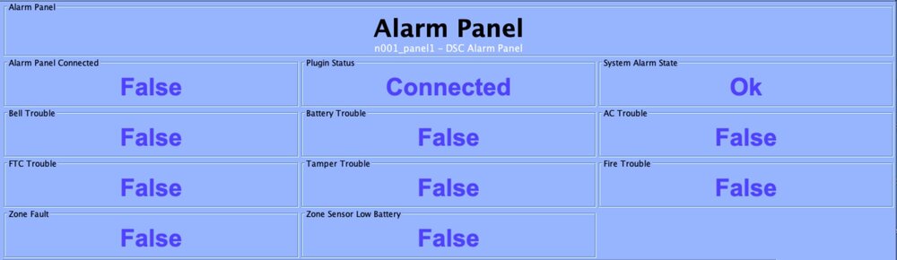

May 29May 29 Author True, but I can see the partition, and the alarm is set at the partition level and not the zone level. When I do add a zone, or all 8, isy shows them as closed (which is good as they don't update with the DSC Neo system).
May 30May 30 So you can see the zones in eisy but not in EyezON? If so, do they change state properly in eisy when activated?

May 30May 30 Author Using the DSC Neo, with the EnvisionLink requires the UNO4 expansion card to allow communication to EyezOn.EyezOn can only arm & disarm the system with the DSC Neo and show whether the system is armed or not. Currently no other feature is available.This is what I was hoping with the the EnvisaLink-DSC in Polyglot 3, allowing me to arm /disarm, and to see the status.Zones status is not available with the current configuration, and the system simply shows ready to arm or not ready to arm, but doesn't tell why in EyezOn. I could purchase an additional UNO8 expansion to add 8 zones, and then move the zones from the DSC Neo to the expansion card to allow EyezOn to 'see' the zones, but the added price isn't work it.All I want is to have the EnvisaLink-DSC module in Polyglot 3 communicate correctly to show arm/disarm and be able to arm/disarm when the status is 'ready' but I continue to see in the Polyglot logs that it cannot communicate with the EnvisaLink card.
