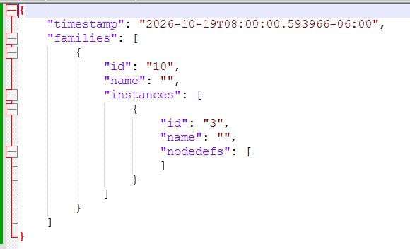

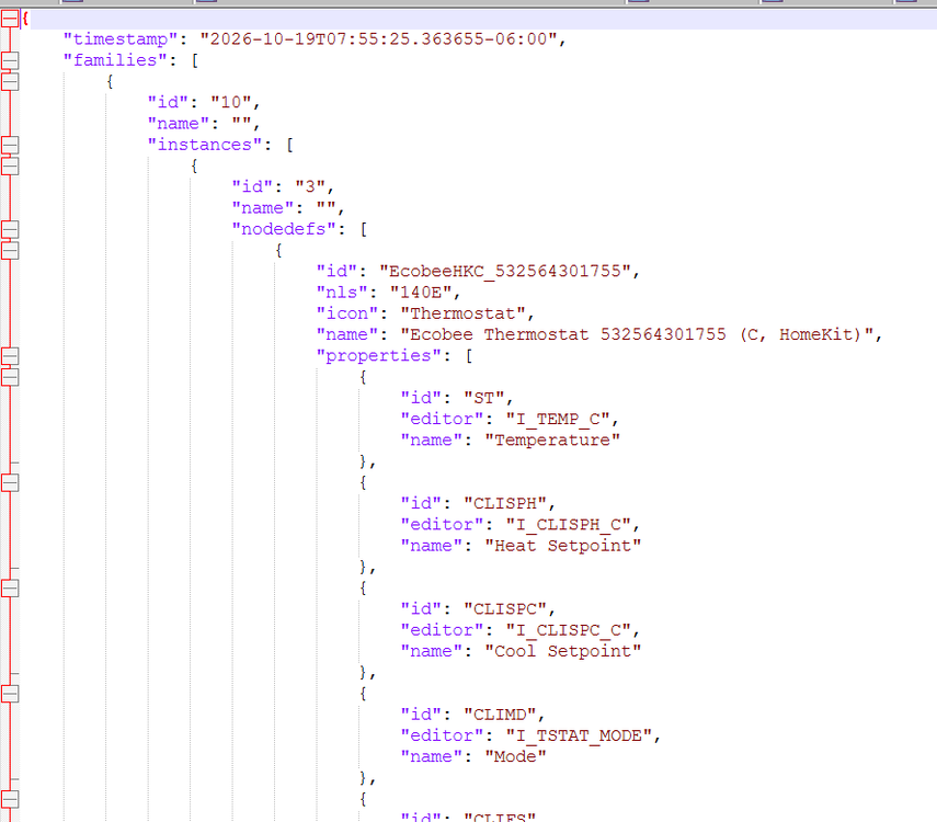

Here are some screenshots of what I see before and after the migration:
1. In the program it cannot set the 'Heat Setpoint'
after migration

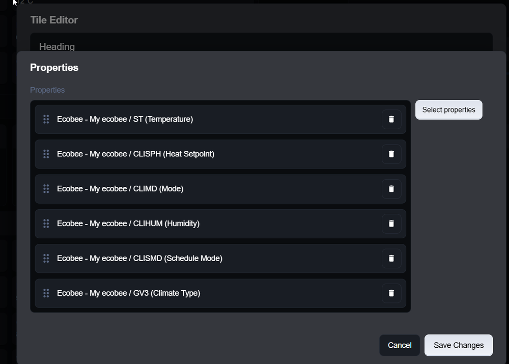

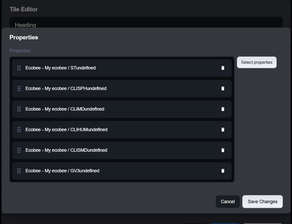

  1. On the home page I have a tile for the main thermostat and here is what I see when selecting the properties
after migration
