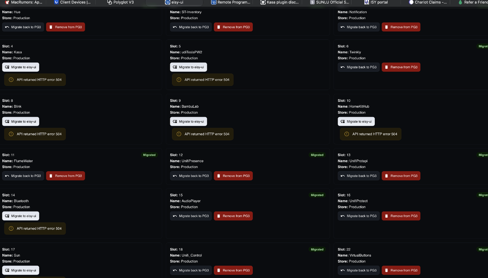

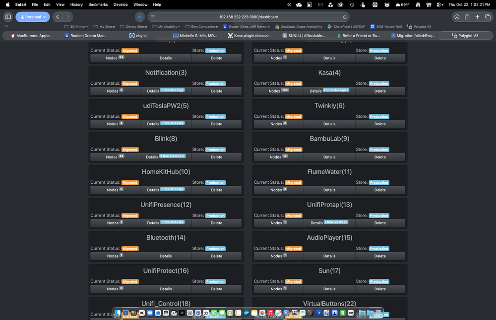

12 hours ago12 hr Yep, same thing is happening to me, but I just left it alone for hours and all of it got migrated perfectly
