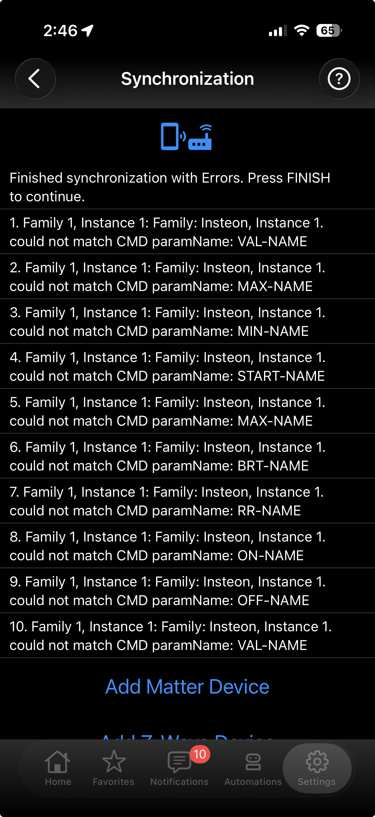

  1. Upgrade went smoothly. After 3 hours EISY did not send notification of being back on line. -- Unit pings -- Portal says the device is online -- Opens EISY-UI to login page and then redirects to port 3000 which does not connect -- No interaction with mobile app -- Unit appears in IoX Admin Console list, but does not present link to open actual console SO: I did a reboot from the hardware console CLI. Everything came up, uname -a reported the correct FreeBSD version -- EISY-UI reverted to HTTP only. HTTPS will not connect -- Listing and editing programs in the UI works well -- Admin Console works great -- UD-Mobile appears to work, however after syncing the app the following screen appears:
