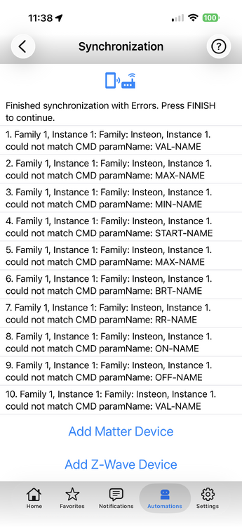

In testing UD Mobile, the Synchronization finishes with Insteon errors " with "...could not match CMD paramName: ______". The paramNames that could not be matched were: VAL-NAME, MAX-NAME, MIN-NAME, START-NAME, BRT-NAME, RR-NAME, ON-NAME, and OFF-NAME.

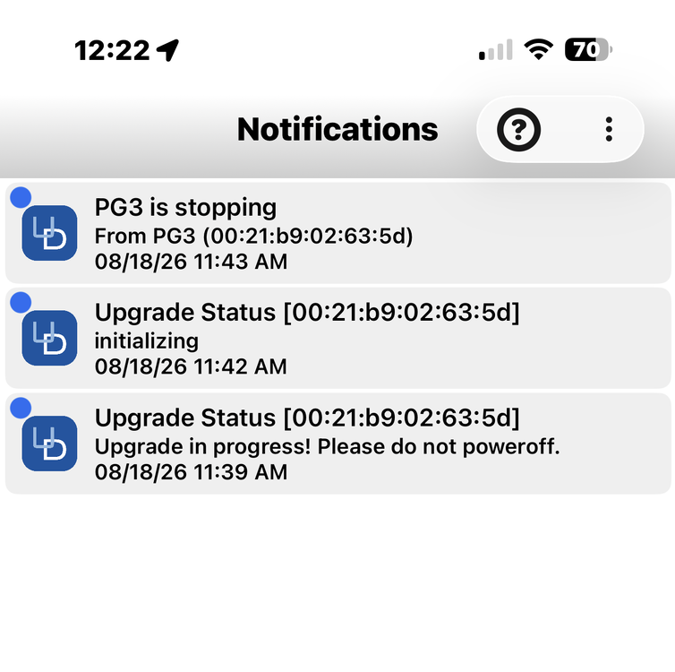

Anyone have opinion of how long this update is suppose to take, My UD Mobile still says Upgrade Status "Upgrade in Progress! Please Do not power off. " after Upgrade stared 2-1/2 hours ago using Addin console.
Did you close the app and relaunch (forcing it to reconnect to the EISY)?
Yes, I selected [Upgrade Packages} from Admin Console/Configuration TAB
Did you close the app and relaunch (forcing it to reconnect to the EISY)? NO,
Thanks for the Info. Since the UD Mobile did not state "Initializing" my guess is the upgrade never started.

After upgrading, the Synchronization with UD Mobile (iOS) produces these errors. However, all the Insteon nodes show up and appear to be fully functional.
