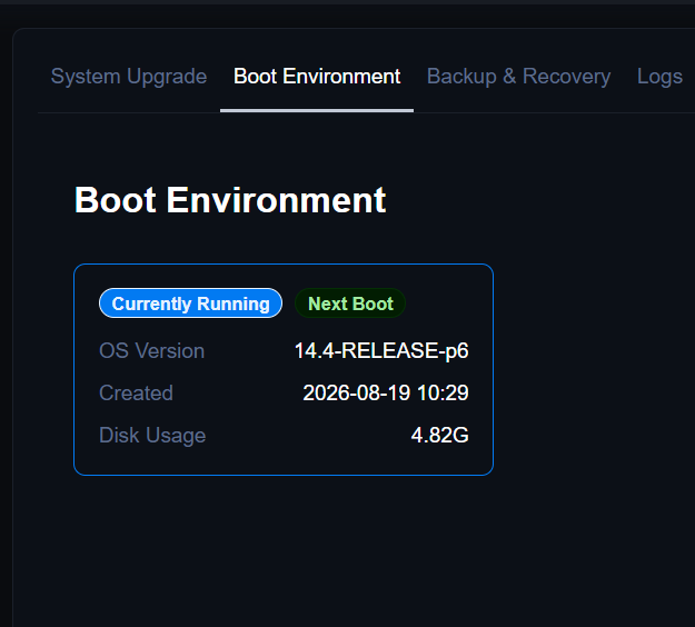

Upgrade seemed to go ok except it keeps telling me I have to go to Configuration, then Upgrade Packages to complete. I do this and it says successful so I reboot and it comes back and says I have to update packages again. Have done this multiple times. everything else still works. I think.
Not exactly sure what you're referring to. Do you mean the boot enviroment
Where you you see partitions?

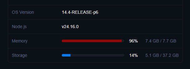

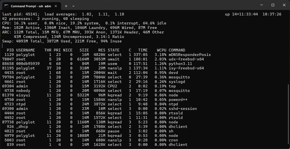

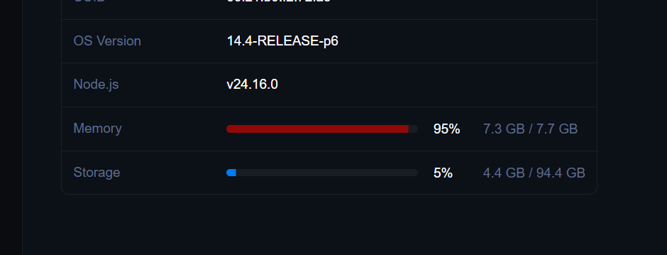

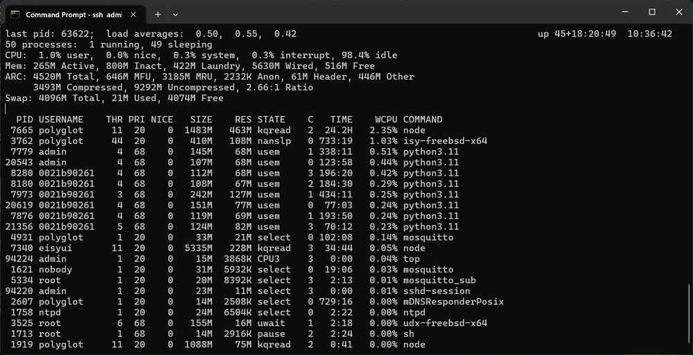

UPDATE
I rebooted the eisy and now memory usage is showing 23%
However, upon reboot all my node servers seemed to hang up. I had to do a restart on them.
After the restart the audio player was showing volume at 40% when in fact it was at max.
