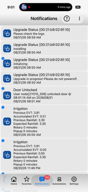

I think it was my fault not rebooting the polisy. I was doing shutdown now -r and should have been shutdown -r now , or better to use sudo reboot
I will try this next time to make sure the argument order is correct. I am used to linux which doesn't have this issue.
However in admin console, restart IoX doesnt seem to work and it hangs, I have to restart again via ssh eg... sudo service isy restart maybe that is not supported command anymore and is old.
