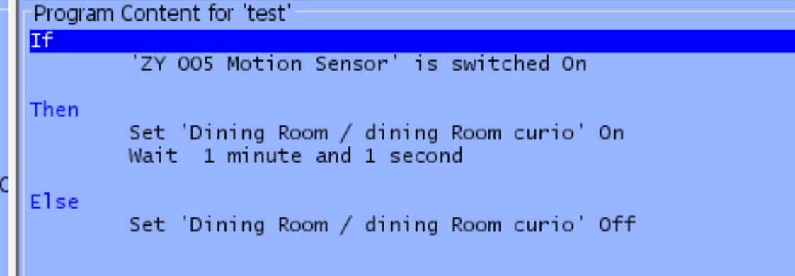

    It didnt work either . The sensor send an on code. I cant tell if it send an off code. You cant read the parmeters that it is factory coded to. I have no way of reading and bit transfers in this programing either. So in this program if it see On it more to the next step and then the next, EVEN if the sensor still on beacuse of movement. It would of been so much easier if it had a dusk to dawn like the old sensor did. I would not have to program. Ideaa??? The now way of having a While statement

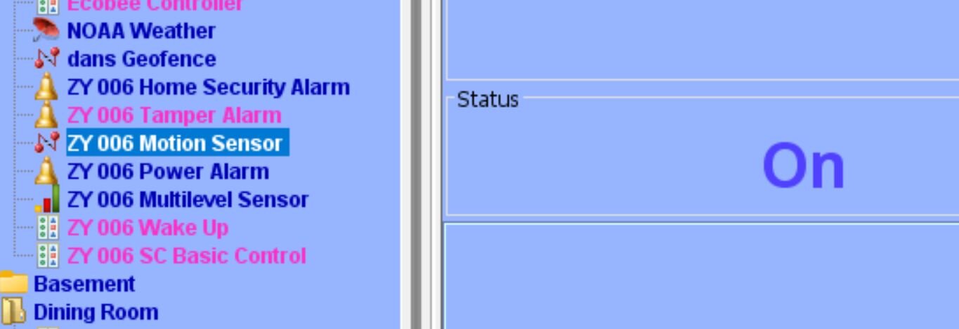

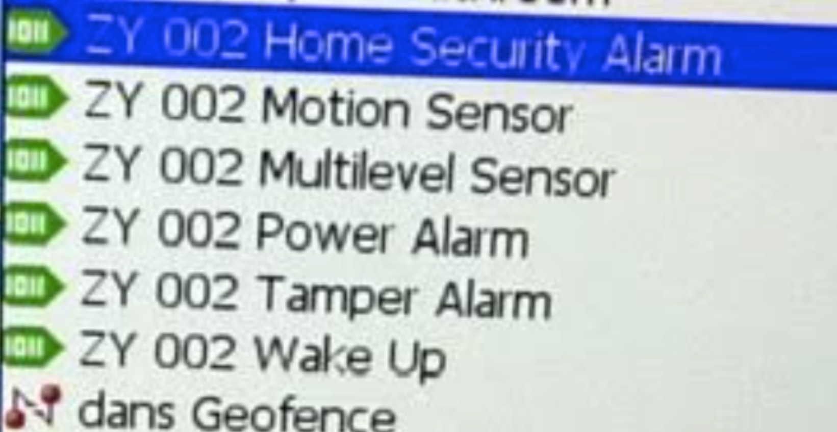

    Here you go Techman It a should be simple. The second picture is how it looked before I reset the sendsor to factory setting. The last picture is how it looks now, but it soon or later will go back to what you see in thr 2nd picture . I apprecite all your help working with me.

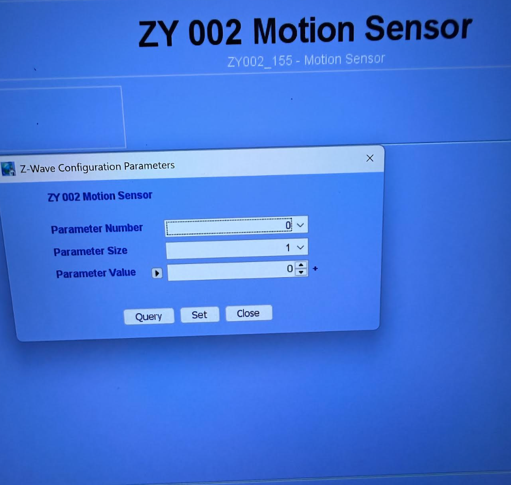

    thanks my question is Motion Sensor right click has parameters Powe alarm has Parameters Which on to you use

    I have a list of the parameters, I gather I have to go get the Sensor and manuly click the button. I have a option on that but I wil lkeep it. LOL Then I upgade any of the parameters.. Is there a way of read the parameters setting that are already set?

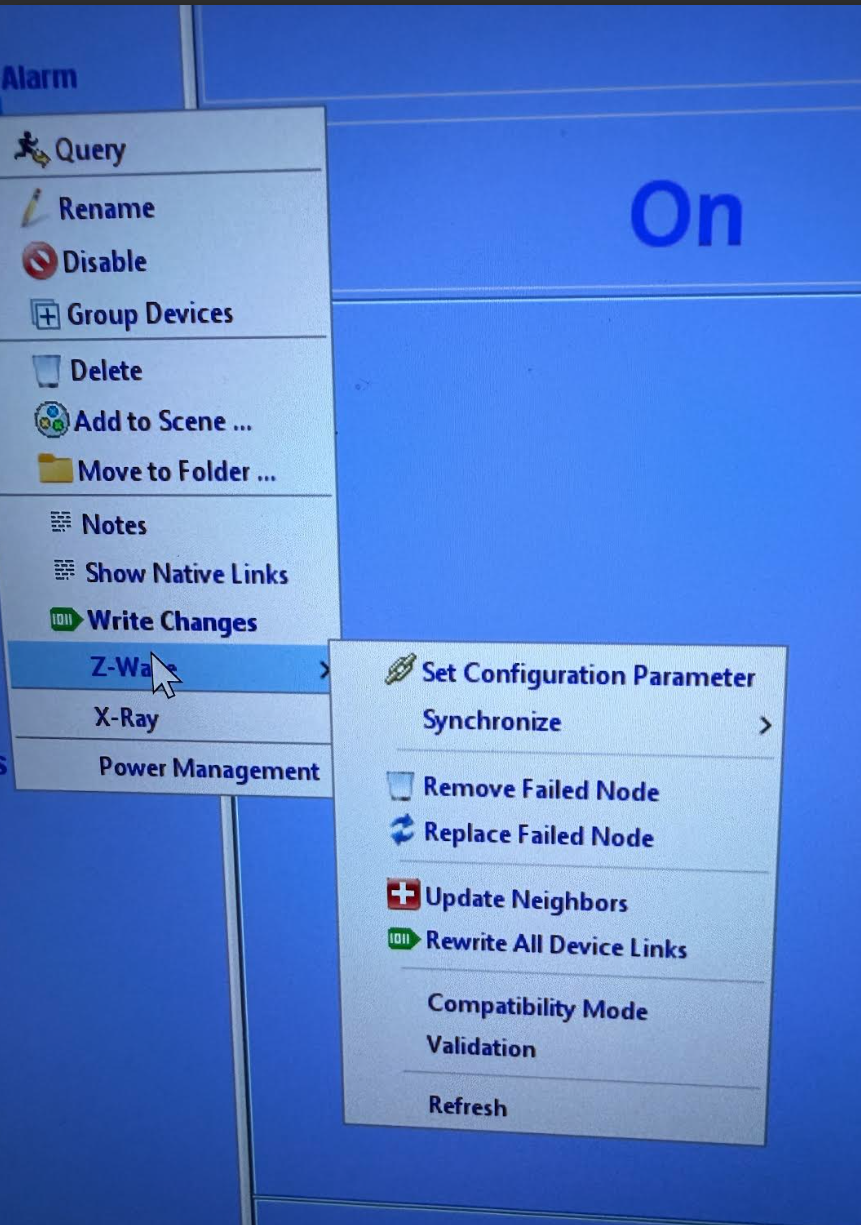

    I still dont Understand. Link NODE.? Insteon I get Link mode. Are you saying that I have go get the sensor and figure out how to put it manully in a link mood. And the term node. I konw what this means when I would progam a PLC, or a robots program. But not in a EISY
  19. danncas replied to danncas's topic in eisy
    Im afraid you already lost me. I do see if I right click on the motion sensor I will see Zwave>

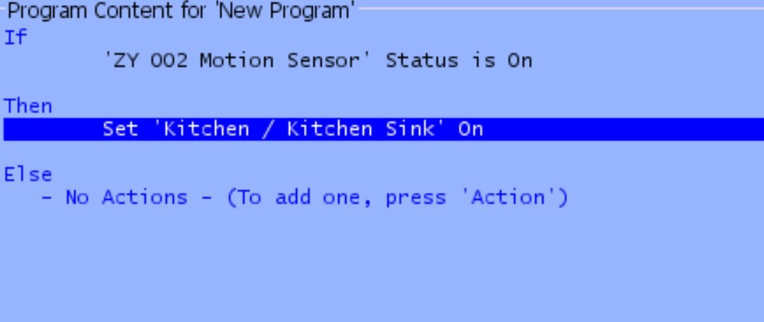

  20. danncas posted a topic in eisy
    Hello folks , New to this Zmatter. I have been able to add it to my Eisy. Now Im nott sure what I'm looking at. !. Is there any way to adjust the sensitivity? What does these setting all mean I did this simple program to test and it works. It different then the inteon there is no dusk to dawn setting, or sensitivity setting or sensing time/period ANY HELP OR IDEAS ARE APPRECIATED THANK YOU
