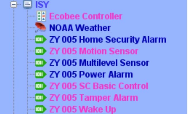

Hello folks , New to this Zmatter. I have been able to add it to my Eisy. Now Im nott sure what I'm looking at.
!. Is there any way to adjust the sensitivity?
  1. What does these setting all mean

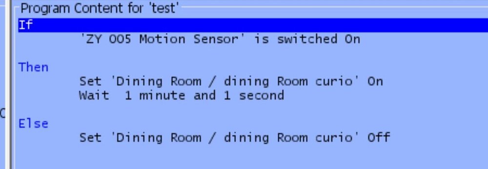

  2. I did this simple program to test and it works.

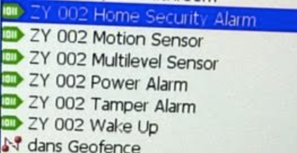

You have pending writes to the device. Put the device in linking mode, then right click on the device in the device tree and click on write updates, all the green should go away once the links have written to the device
You can ignore the extra nodes if you're not using them

Try clicking on the other nodes associated with the motion sensor, one of them will show the write update option
danncas
My experience with Zwave has always been interesting and mostly successful. The instructions that are given are hard to read but all the information should be there. As Techman indicated, put the sensor in linking mode and all of those green 1011 arrows should go away. After you do that, look at the instructions that came with the device and start to experiment. After you introduce the parameters you query the device and they should take effect. I think that I may have had to manually put the device back in link mode for the parameters to take hold. Zwave devices all are supposed to adhere to a standard and I believe that I was able to get more useful online from Zooz , It is as always a GREAT IDEA to backup everything prior to making any new additions or changes. Zwave is worth the effort in my opinion. I started using it do deal intermittent instion issues, so far I am happy.

You can use either, push the set button on the sensor, its led wil be blinking, then in your device tree right click on the device and click on Write Updates

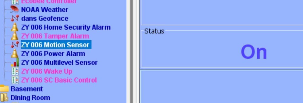

Here you go Techman It a should be simple. The second picture is how it looked before I reset the sendsor to factory setting. The last picture is how it looks now, but it soon or later will go back to what you see in thr 2nd picture . I apprecite all your help working with me.
Edited by danncas
It didnt work either . The sensor send an on code. I cant tell if it send an off code. You cant read the parmeters that it is factory coded to. I have no way of reading and bit transfers in this programing either. So in this program if it see On it more to the next step and then the next, EVEN if the sensor still on beacuse of movement. It would of been so much easier if it had a dusk to dawn like the old sensor did. I would not have to program. Ideaa??? The now way of having a While statement
Edited by danncas
If the motion sensor times out before 1 minute, 1 second then the THEN clause will stop before it can turn off the light.
Change the timing to 10 seconds and see if it turns off the light

Change the timing to 10 seconds and see if it turns off the light The motion sensor doesnt time out as long as it sees motion. But the progam will sill turn of the light even if there is motion. Thats the whole problem. I want to the light to staay on as long as the motion is TRUE.
Change the program to this:
IF
ZY 005 Motion sensor STATUS is ON
THEN
Set Dining Room / dining room curio ON
ELSE
Set Dining Room / dining room curio OFF
Thchman I did some experimenting after I did another factory reset. I found out that after it goes to the OFF status after no motion it takes 30second before it changes the true output. So It seem I got it to woork now so far in my test . I put a time frame in where it will only work and the told it to turn on the light if it sees motion. So I test the it and it stay off even when it say me. Sofar so good . Im going to try the sunset to sun raise tonight. Fingure crossed thanks again
