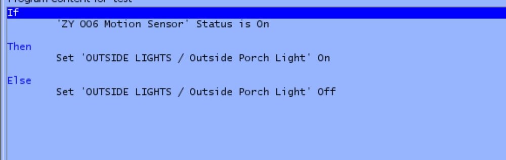

If you don't post a screenshot of the program you're using to turn on and off the light then I'm unable to help you,
I want to try on more thing he is the screenshot. It seem to work like this tested it several time. I will test it tonight several times. We Will SEE

Your program is correct
If you want to have the light stay on longer you can add a wait statement to your else clause
ELSE
WAIT 5 mintues
Set outside lights / Outside Porch Light OFF
@danncas
If you only want the motion sensor to turn on the light when it's nighttime then you can add a time statement to your else clause. Somthing like this:
