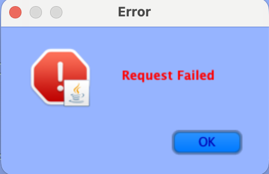

I'm getting this message when I query any one of the Zigbee devices. It seems that there is possibly one node from one device that is working (alarm siren) however all other nodes from this device seem to be blank and unavailable... I just can't remember if they were like that before or not. The alarm sensors (water alarm sensors) all seem to be failing to communicate.

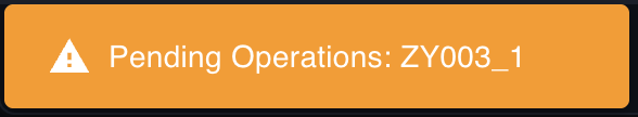

When I query it I get:

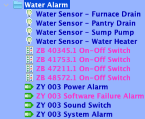

Here's a list of these devices (my only Zigbee devices):

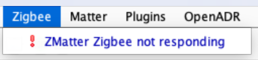

Also in the Java Admin Console, I'm seeing this when I click on the Zigbee menu across the top:

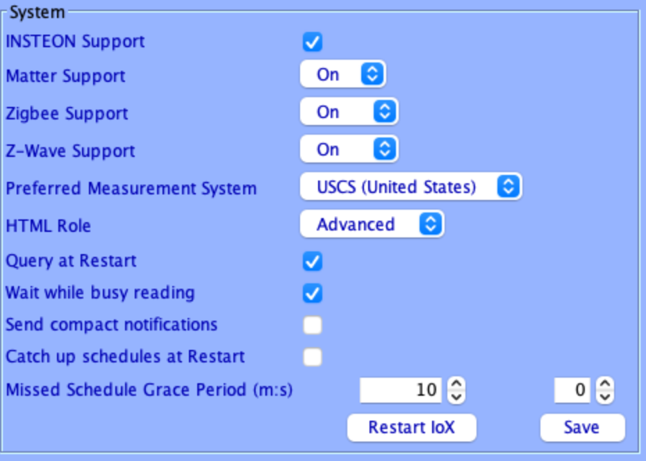

Also, yes, it is all turned on in the configuration pane:

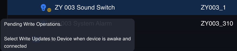

Well it looks like that kick-started all of the Zigbee devices (they seem to be reading states now in the admin console) however I am still getting that same "Pending Operations" message and now see this in the web UI when I hover over the device:
The Zigbee menu across the top of the Admin Console is now live and working correctly... so wondering if there's something that needs to be done and triggered now that the dongle is awake?
I tried to "write changes" from the admin console first and then from the web UI and nothing happens... looks like that device is somehow stuck for some reason however it's showing the alarm state itself, so I'm not sure what's going on. I've created a support ticket, I'll post back what we find. Thanks again.

Is the device (the ZY 003 Sound Switch) a battery powered device? If so, do whatever is needed to activate it, and then do "Write Changes" (by right clicking on the node in Admin Console).
This seems to have done the trick... it's a plug-in siren that has a built in battery backup. I pulled it from the wall outlet to force it onto battery then performed write changes and it updated all of the icons to what they were before in the admin console. The "write changes" is still there however I think it's working now. Thank you!
