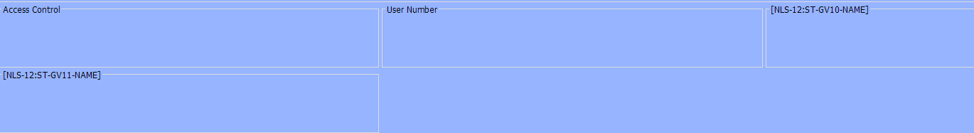

  12. ronbo posted a topic in ZMatter
    I have my lock functioning on 5.5.3 on my Polisy. My Door lock has 3 nodes. ZY 008 Door Lock ZY 008 Access Control Alarm ZY 008 Assoc Only on the ISY I was able to access the user number that unlocked the door my accessing the USRNUM from the main node. On Zmatter the usrnum is not on the main node, but on the Access Control Alarm and I really don't see how to access that info in a program. Any help is appreciated
