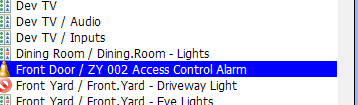

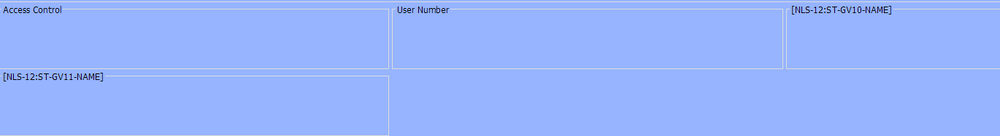

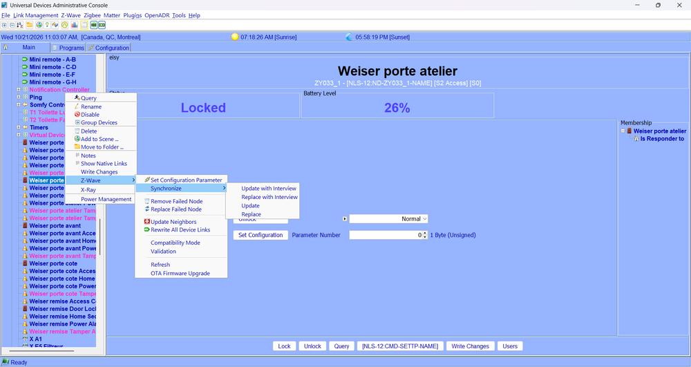

October 21Oct 21 Running 6.1.2 on EISY, This is a Zwave lock that has been in the system for years. it appears that some of the parameter names are missing, also in my program i have the followingWhile this still show in the program, and appears to execute properly the Lock(ZY 002) no longer shows as an option in the device list.
October 21Oct 21 Please check eisy-ui, from 6.1.2 admin console is deprecated and should only be used for a small hand full of thing that do not exist in eisy-ui.If eisy-ui shows errors, this would be the starting point of diagnostic.
