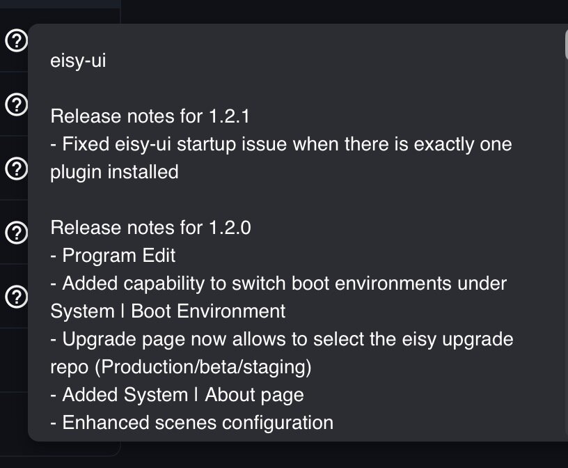

I, along with chatGPT, found and fixed my issue, the eisy-ui is now running, the PG3 dashboard is now also looking good, and the online connection is green too.
It seems there is a bug in the "pluginConnections.js" file. If you have MORE THAN 1 plug-in installed, it will work fine. If your have 0 or 1, it will fail.
"If so, eisy-ui 1.2.0 has a clear empty-list programming bug: this line assumes connection always exists:" on line 27.
ChatGPT supplied a fix, I installed and ran it. All good now.

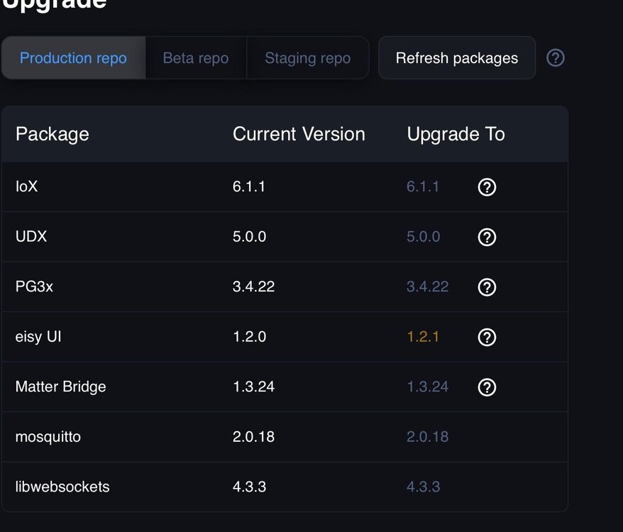

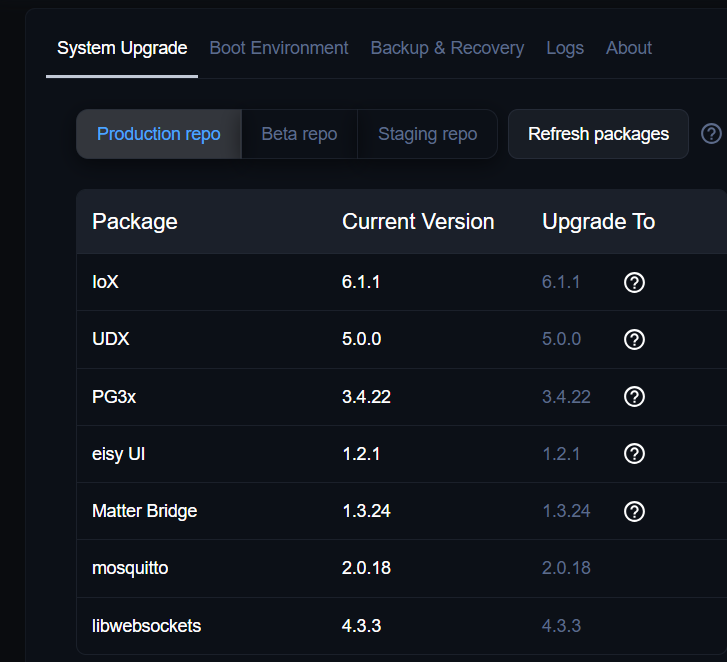

After manual reboot, appears all is up and running. Two notes:
-EISY was so hot, I couldn't hold it.
-UDI fixed the single plugin issue above as I have to upgrade again to get the latest UI.
Will see what happens next!
Screenshot 2026-08-18 at 3.08.44 PM.jpgScreenshot 2026-08-18 at 3.11.30 PM.jpg
Runtime from upgrade button in AC to reboot: 24 minutes
Runtime from reboot button in AC to
  • AC accessible: 5 minutes
  • eisy-ui accessible: 13 minutes
  • PG3 accessible: 18 minutes
Total upgrade time ~42 minutes.
