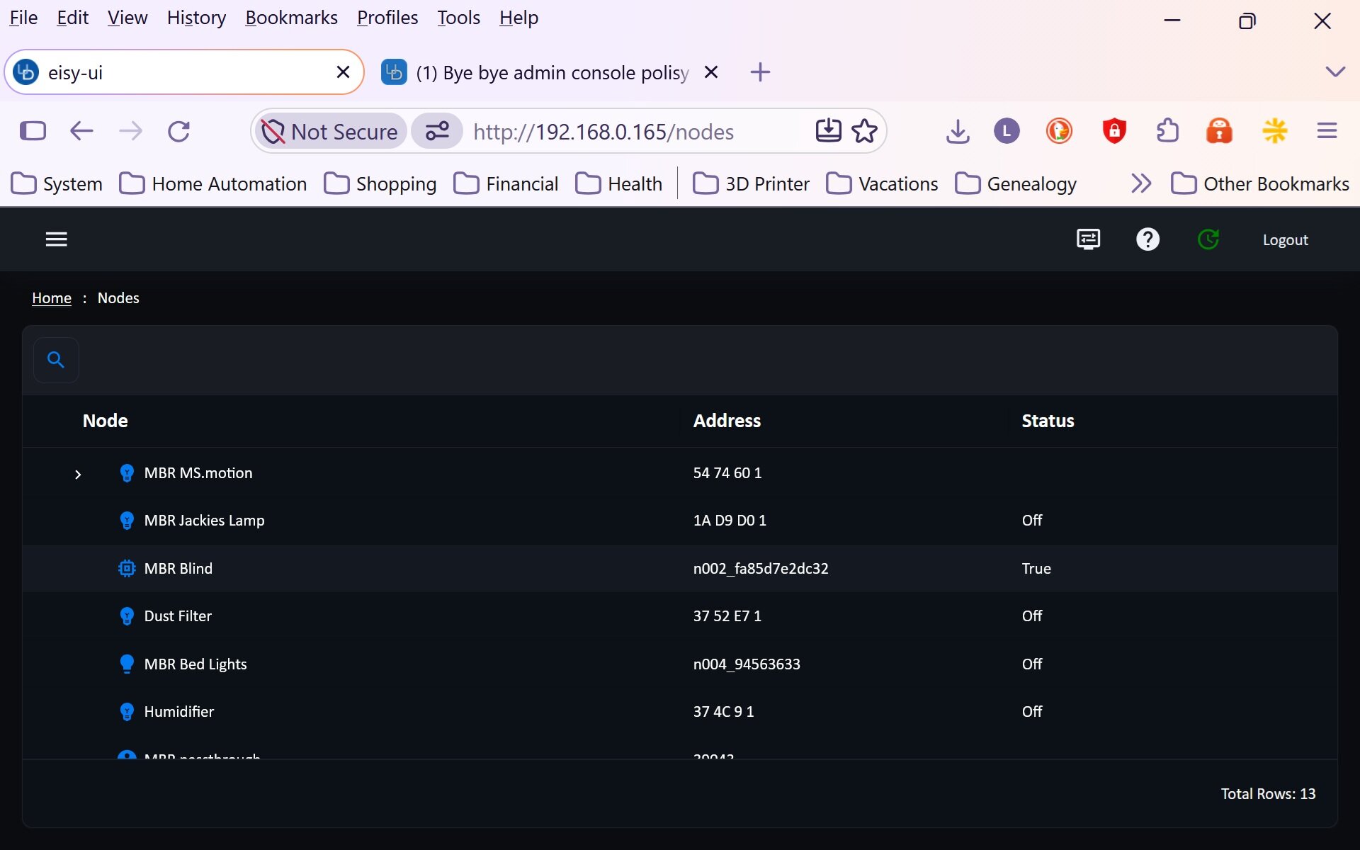

  8. Mine were all working fine and the offer came to delete the ones from the OLD system PG3x. It also deleted the nodes from IoX as well and they ceased to exist completely in programs and node lists.
  9. All sounds familiar. I have restored my PG3x plug-ins and have hesitated to try again with eisy-ui. Nice I/F but caused too many problems. Now I am trying to install the HomeHubKit along with ecobee but it seems PG3x plug-ins are none existent will not even respond with a negative message. I am just about to just give up. IoX spews a lot of garbage messages to be cleared, on the screen now, every boot-up. Nonsense messages about new Insteon devices and old events, repeated several times. Very frustrating.
  10. Others, including myself, and @oberkc have had some problems with eisy-ui plug-ins deleting PG3x plug-ins from IoX completely. Still some migration bugs there.

  13. larryllix replied to ErikN's topic in eisy

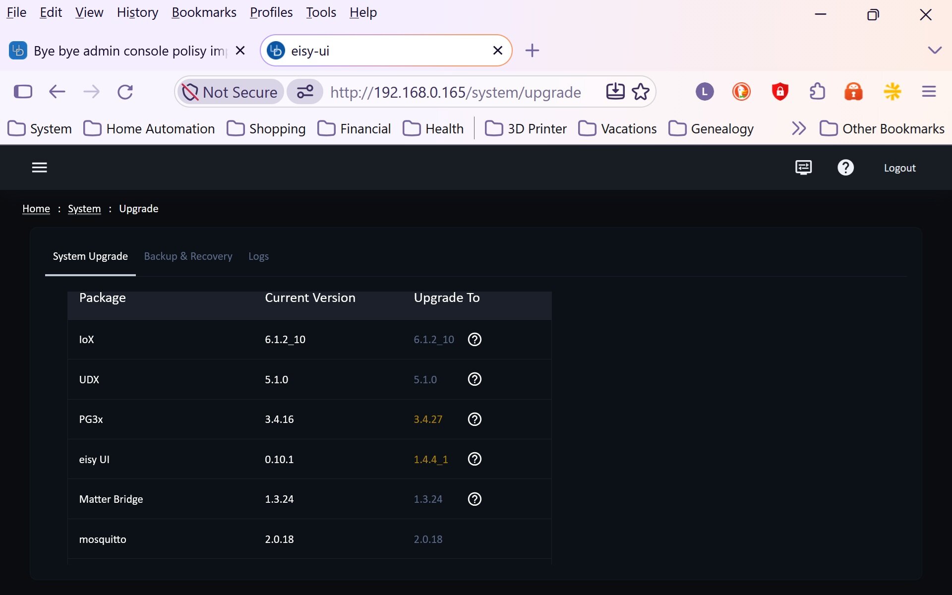

  24. That is the 64 GB, fully captured by the polisy system.
