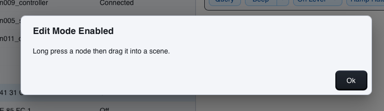

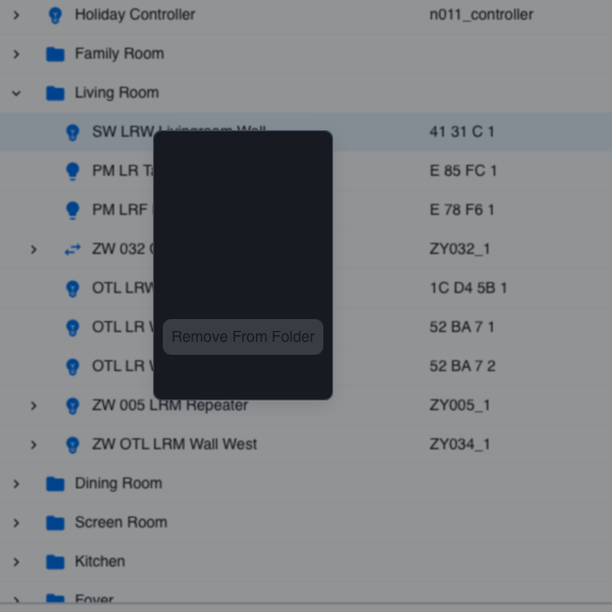

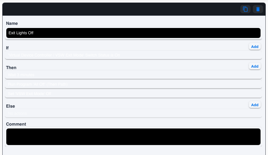

September 4Sep 4 2 hours ago, Michel Kohanim said:we need specific feedback.okFrom the HTML version (is there a way to sort these alphabetical?), when I click on a device, I get a blank (black) box.Also, when I click on a device, I don't see any lists of scene memberships for that device.When I hover over the blank box, the text DOES show up, but one line at a time and barely readableWhen I try to add a device to a "group" (is this the former "scene"?), I click on the "add to group" option and it gives me this message:I click and hold on a node, but it does not allow me to drag it anywhere. So...for me, adding devices to scenes/groups is non-functional.Moving on, selecting a particular program shows a bunch of blank lines: I can click on individual lines and it will show the content of that one line, but there seems to be no way to see the program in its entirety. And I cannot easily see the parenthetical relationships when they exist in a program condition.Perhaps I am missing it, but I don't even see a way to add a new device, whether Insteon, zwave, zigbee.I have not made an exhaustive effort to test all the available functions of the HTML version. Instead, I open the HTML version when I want to modify something in my system. When I cannot find a way to make the modifications that I want, I tend to go back to the java interface (which is the result a vast majority of the time).Maybe I am missing something or maybe this is a learning curve issue or maybe this is somehow unique to my system, but these issues suggest to me that we have a ways to go before the HTML version is ready to take over. I would think that we would want a transition time of several months, when both HTML and java are fully funtional before we pull the plug on the java version. I hope this is helpful.
September 4Sep 4 1 minute ago, oberkc said:okFrom the HTML version (is there a way to sort these alphabetical?), when I click on a device, I get a blank (black) box.Also, when I click on a device, I don't see any lists of scene memberships for that device.When I hover over the blank box, the text DOES show up, but one line at a time and barely readableWhen I try to add a device to a "group" (is this the former "scene"?), I click on the "add to group" option and it gives me this message:I click and hold on a node, but it does not allow me to drag it anywhere. So...for me, adding devices to scenes/groups is non-functional.Moving on, selecting a particular program shows a bunch of blank lines:I can click on individual lines and it will show the content of that one line, but there seems to be no way to see the program in its entirety. And I cannot easily see the parenthetical relationships when they exist in a program condition.Perhaps I am missing it, but I don't even see a way to add a new device, whether Insteon, zwave, zigbee.I have not made an exhaustive effort to test all the available functions of the HTML version. Instead, I open the HTML version when I want to modify something in my system. When I cannot find a way to make the modifications that I want, I tend to go back to the java interface (which is the result a vast majority of the time).Maybe I am missing something or maybe this is a learning curve issue or maybe this is somehow unique to my system, but these issues suggest to me that we have a ways to go before the HTML version is ready to take over. I would think that we would want a transition time of several months, when both HTML and java are fully funtional before we pull the plug on the java version.I hope this is helpful.Please use dark mode until next release, this will clear some confusion.Sort is in the column header, not the row. The terminology Scenes has been updated. Groups are the group of devices, a scene is how a controller controls the responders. Click on a Group to see the members, click on a responder to see the Scene.I cannot replicate missing drag and drop. when enabled from Edit button or from Add To Group or Move to Folder.Screen Recording 2026-09-03 at 8.39.29 PM.mov
September 4Sep 4 22 minutes ago, Javi said:Please use dark mode until next releaseI thought you suggested light mode in response to complaints that it was hard to read. Regardless, I have forgotten how to switch between modes.This is what happens when I try to add a node to a group:Screen Recording 2026-09-03 at 11.10.30 PM.mov
September 4Sep 4 20 minutes ago, oberkc said:I thought you suggested light mode in response to complaints that it was hard to read. Regardless, I have forgotten how to switch between modes.This is what happens when I try to add a node to a group:Screen Recording 2026-09-03 at 11.10.30 PM.movAlt + t,What browser? Tested on Chrome and Safari and can not replicate. In the video the target is not being shown (hand icon).
September 4Sep 4 6 hours ago, Javi said:What browser?Safari.FYSA...upgrading to beta did not solve this problem for me. Edited September 4Sep 4 by oberkc
September 4Sep 4 4 hours ago, oberkc said:Safari.FYSA...upgrading to beta did not solve this problem for me.Does drag and drop in program conditions (IF) or Actions (Then Else) work? No edit mode jus long click then drag, Save cancel will be shown at the top it will not automatically save.
September 4Sep 4 20 hours ago, sjenkins said:I think they are ALWAYS looking for specific feedback. Just saying it sucks is usually not a path to continuous improvement.In my defense, I did not say "it sucks". I may have implied that it was not quite ready for prime time, however. Furthermore, despite the response we sometimes get from owners and employees of the company, I have always viewed this as an user-to-user forum and not necessarily an official channel to provide feedback to the company.
September 4Sep 4 3 hours ago, Javi said:Does drag and drop in program conditions (IF) or Actions (Then Else) work?Yes
September 4Sep 4 2 hours ago, oberkc said:YesOk thanks. Nodes Page scheduled for virtualization which will likely fix (same as program edit). However we should add a section dialog to complement drag and drop.Created issue to add a selection dialog. Issue ID: /eisy-ui/issues/56
