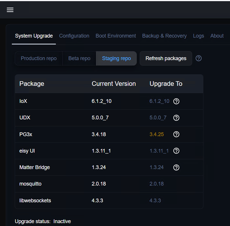

October 6Oct 6 59 minutes ago, Michel Kohanim said:@apostolakisl , if you are in the staging repo, we made massive changes to support polisy upgrade through eisy-ui (udx 5.0.0_7 to be exact). The only thing is that it will not upgrade the OS above 14.3p5 AND we have no way of testing everything against the old OS. So, although we believe things should continue working, it's just not a guarantee.With kind regards,MichelThis is where eisy ui says I am after the ssh upgrade. It appears I am in the staging repo. I don't know that I need cutting edge features on this polisy, but I would like to be certain it keeps working smoothly, especially with UD mobile.

October 6Oct 6 15 hours ago, Michel Kohanim said:@apostolakisl , if you are in the staging repo, we made massive changes to support polisy upgrade through eisy-ui (udx 5.0.0_7 to be exact). The only thing is that it will not upgrade the OS above 14.3p5 AND we have no way of testing everything against the old OS. So, although we believe things should continue working, it's just not a guarantee.With kind regards,MichelSo does this mean if my Polisy is on the Beta repo at 5.0.0_4, I cannot update using the Upgrade Packages button and need to do another SSH update at some point?Or, should I switch over to the Staging repo?
October 6Oct 6 2 minutes ago, peterathans said:So does this mean if my Polisy is on the Beta repo at 5.0.0_4, I cannot update using the Upgrade Packages button and need to do another SSH update at some point?Or, should I switch over to the Staging repo?You need to switch to staging, and then upgrade udx first. Then you can go back to Beta/Production and from then on, you can upgrade using eisy-ui.With kind regards,Michel
October 6Oct 6 Thanks - when you say "upgrade udx first", I assume you mean Upgrade Packages (which upgrades everything)? I don't see an option to upgrade just one specific component like UDX.
October 6Oct 6 37 minutes ago, peterathans said:Thanks - when you say "upgrade udx first", I assume you mean Upgrade Packages (which upgrades everything)?I don't see an option to upgrade just one specific component like UDX.You'll need to do that one by ssh:sudo repo.stagingsudo pkg upgrade udx eisyuisudo reboot Then you'll be able to use eisyui for updates

October 16Oct 16 On 10/8/2026 at 9:31 AM, Javi said:An update was pushed to Polisy staging to address issue, but must be on 5.0.0_8. If lower ssh is still required for eisy-ui update.For anyone else reading this PLEASE check the OS version first!Why is it that even as of today, I can only see 5.0.0_7 as an "Upgrade To" option for UDX?This is on all three repos (Production, Beta, and Staging) even after pressing the Refresh Packages button.Where can I find 5.0.0_8?
October 16Oct 16 3 minutes ago, peterathans said:Why is it that even as of today, I can only see 5.0.0_7 as an "Upgrade To" option for UDX?This is on all three repos (Production, Beta, and Staging) even after pressing the Refresh Packages button.Where can I find 5.0.0_8?Must update via ssh to get to 5.0.0_8
October 16Oct 16 @Michel Kohanim When you say "please refresh" are you talking about the Refresh Packages button? I've pressed it many times (in all three repos) and it never shows anything other than 5.0.0_7 available for UDX.Keep in mind I'm on a Polisy, if that makes a difference. Edited October 16Oct 16 by peterathans
October 16Oct 16 @peterathans ,If Refresh Packages does not work, use ssh to upgrade udx only.sudo pkg upgrade udxWith kind regards,Michel
