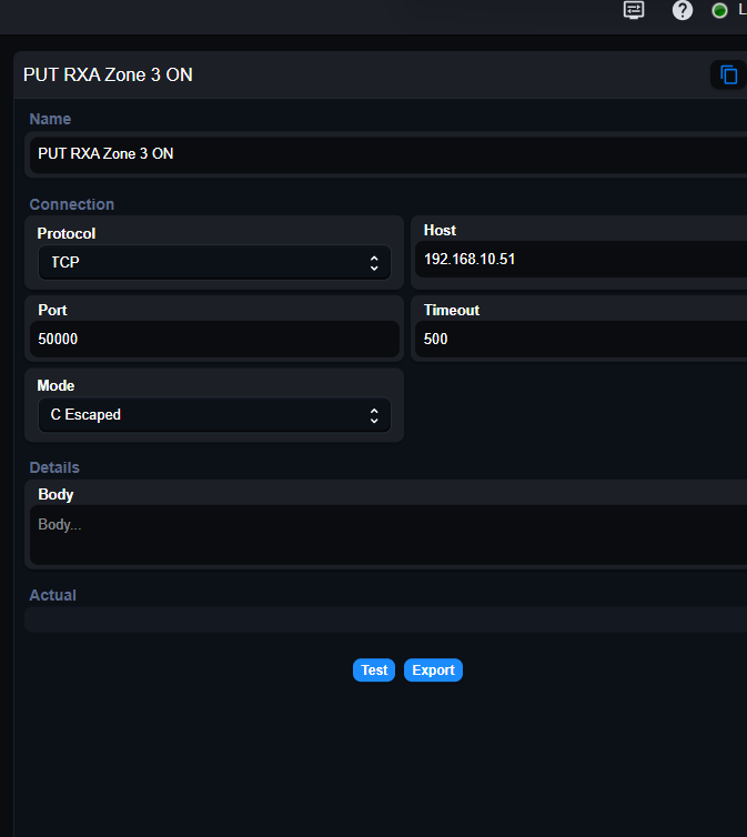

  14. Good news! service restart did the trick. No further API errors that I can see. Also, Network resources are displaying properly and the Test button is functioning again. Thanks once again for your assistance!
