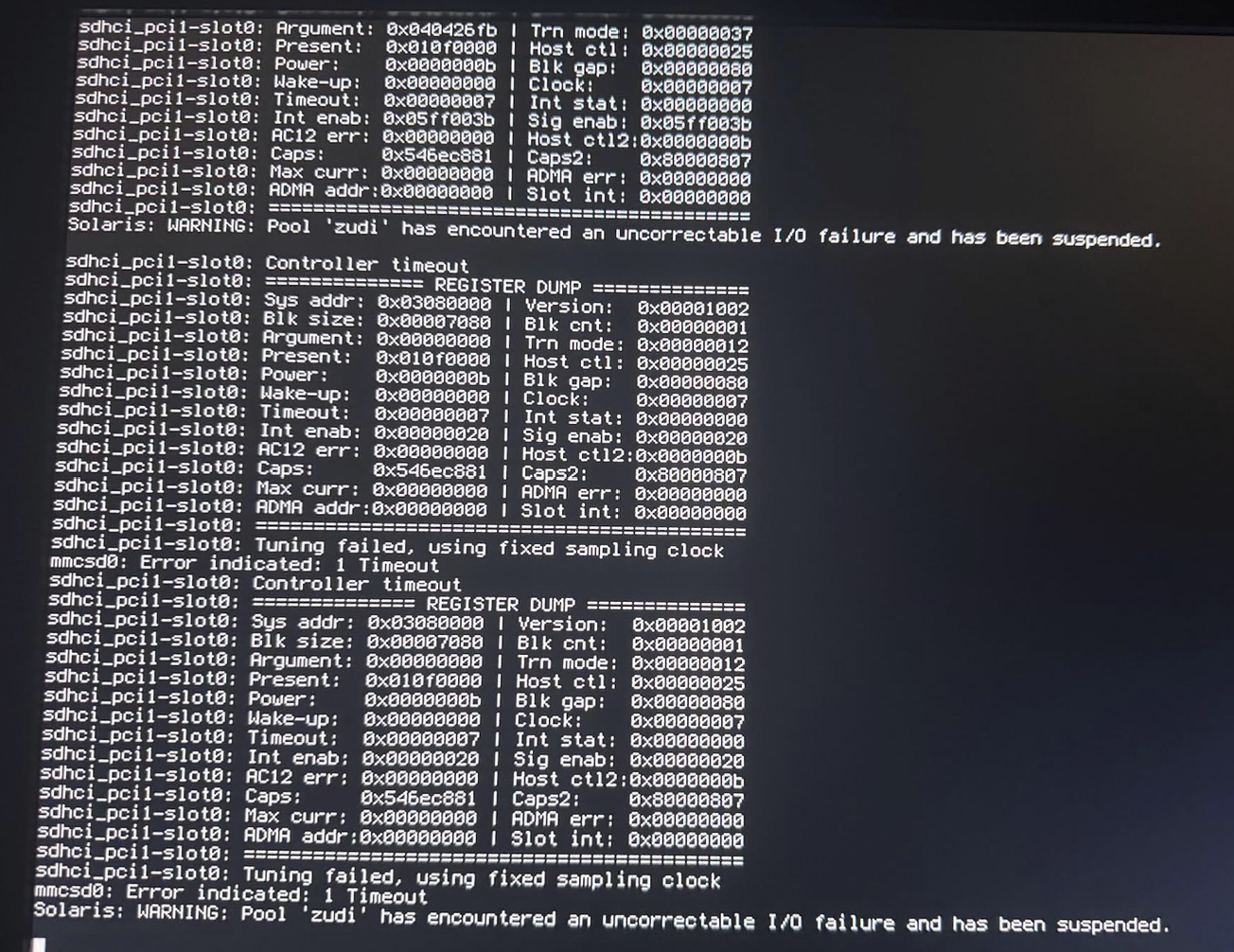

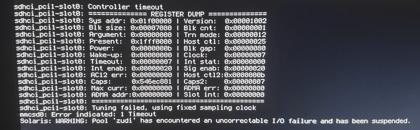

  2. Interesting. Another lock-up occurred overnight. I haven't rebooted yet. I need an escalation plan; the repeated hard fails are not sustainable. Does anyone have a suggestion? I will pull a ticket, referencing this thread. The display tail of error messages this morning on console seems the same last two times:

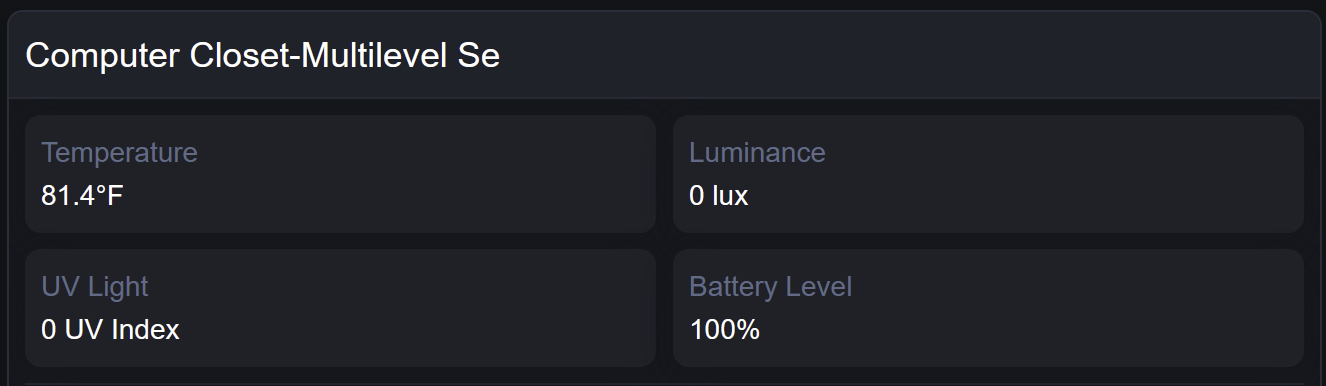

  3. It's in a computer closet with a reasonably controlled environment. Current ambient is only 81.4F. eisy itself feels warm to the touch, not hot.

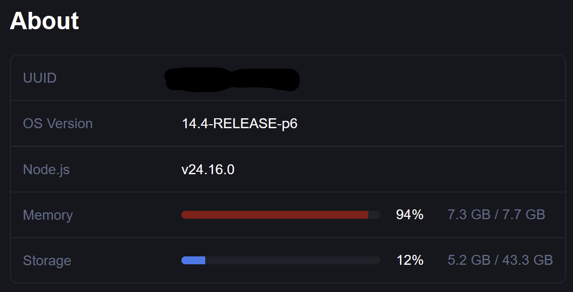

  5. Overnight, memory utilization (as indicated in eisy-ui) spiked to 94%. Less than 0.5 GB remains free per system monitor (189M Active, 700M Inact, 7812K Laundry, 6270M Wired, 465M Free). Nothing strikes me as inherently problematic in that, but it might be notable that someone at UD decided to code the thermometer bar to present in RED rather than BLUE at these levels. Is there something else I should be checking? ... or just wait for lock up and then pull some log?
  6. Will do, Guy. So far so good; the memory utilization (as indicated in eisy-ui) has been hovering around 25% and about 6GB of free memory is showing in freeBSD system monitor. Agree on unusual. Reliable, non-stop unattended performance is really the isy value proposition, but these recurring lockups are now of concern. I will give it 48 hrs, checking memory; failures appear to occur in early AM. If there is anything else you'd suggest monitoring or checking, let me know.
  7. Thanks, Guy. I understand the up pressure from memory paging and caching. The real problem is the repeated lock ups, requiring hard restart. The eisy-ui's RED symbology for the 95% utilization is what caught my attention. Next time, I'll check the proportion of the pool containing active pages, leaving aside dirty inactive pages.

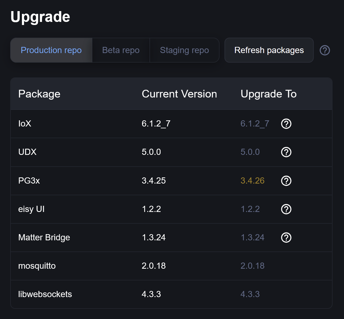

  8. Done. As expected, down to 24% (1.8 GB / 7.7 GB). I guess we'll have to see if it creeps back up over the next 36 hrs.
  9. I've recently had two lockups of the same eisy since updating to 14.4-RELEASE-p6. The lockups were roughly 48 hours apart. In each case, the console showed a controller timeout and register dump together with an indication of an unrecoverable I/O failure in the ZFS pool. See below: After reboot, I ran a zpool status, which reported no errors. It's now been about 36 hours since the last lock up, and I noted the following in eisy-ui: Is there possibly a memory leak in IoX 6.1.2_7? What do you suggest?
