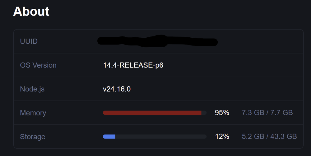

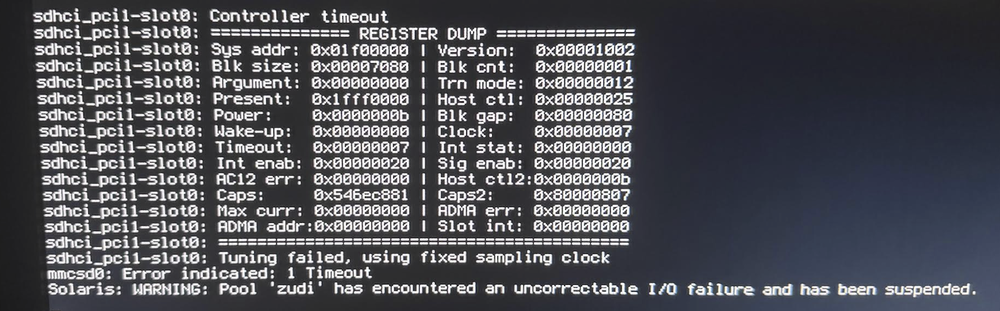

October 8Oct 8 I've recently had two lockups of the same eisy since updating to 14.4-RELEASE-p6. The lockups were roughly 48 hours apart. In each case, the console showed a controller timeout and register dump together with an indication of an unrecoverable I/O failure in the ZFS pool. See below:After reboot, I ran a zpool status, which reported no errors. It's now been about 36 hours since the last lock up, and I noted the following in eisy-ui:Is there possibly a memory leak in IoX 6.1.2_7? What do you suggest? Edited November 10Nov 10 by automatewhatican fix typos; improve precision; revise title for solution indexing

October 8Oct 8 Author 23 minutes ago, Techman said:Do a power cycle, that should clear things upLet me know if the memory usage went downDone. As expected, down to 24% (1.8 GB / 7.7 GB). I guess we'll have to see if it creeps back up over the next 36 hrs.

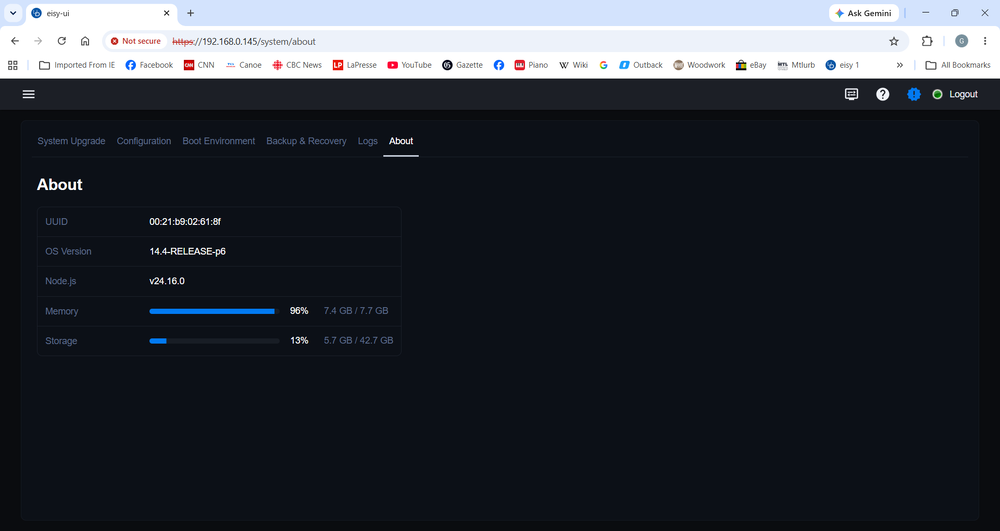

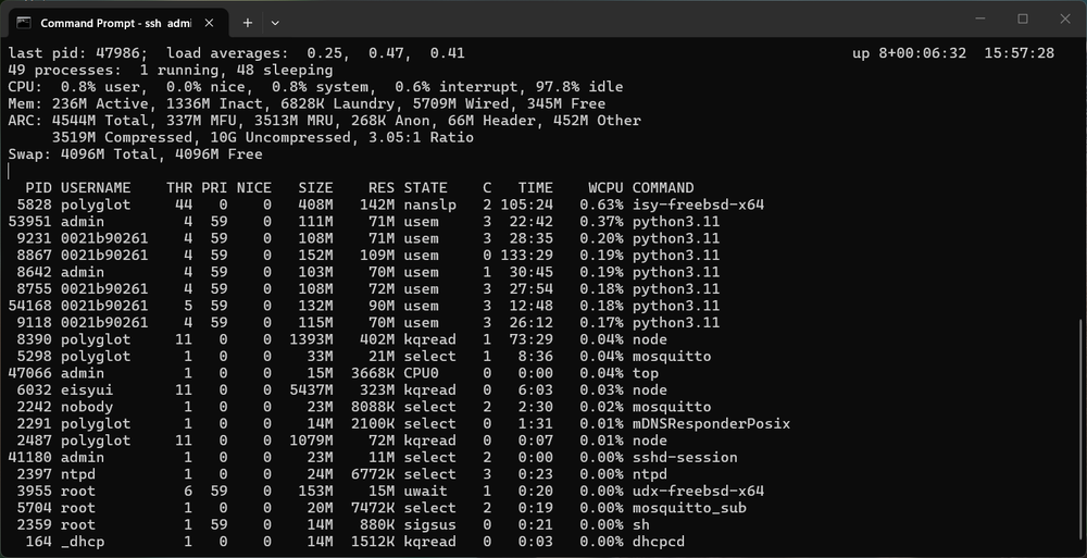

October 8Oct 8 The "high memory usage" is a bit of a myth. What's happening is that eisy-ui is only looking at the "Free" (ie: never used) memory. Unix is a memory paging system and uses disk caching (buffers) for speed, so it will use almost all available memory for caching if it's not needed for actual tasks. So memory useage will always appear high. This is my eisy below. Look at the "Mem:" line: the 6828K "Laundry" usage is caching, buffers that ultimately get written out. The memory actually available is usually considered to be "Free" + "Inact"(ive). The screen below that is the "About" screen, reflecting only the 345M as being free.
October 8Oct 8 Author 19 minutes ago, Guy Lavoie said:The "high memory usage" is a bit of a myth. What's happening is that eisy-ui is only looking at the "Free" (ie: never used) memory. Unix is a memory paging system and uses disk caching (buffers) for speed, so it will use almost all available memory for caching if it's not needed for actual tasks. So memory useage will always appear high. This is my eisy below. Look at the "Mem:" line: the 6828K "Laundry" usage is caching, buffers that ultimately get written out. The memory actually available is usually considered to be "Free" + "Inact"(ive). The screen below that is the "About" screen, reflecting only the 345M as being free.Thanks, Guy. I understand the up pressure from memory paging and caching. The real problem is the repeated lock ups, requiring hard restart. The eisy-ui's RED symbology for the 95% utilization is what caught my attention. Next time, I'll check the proportion of the pool containing active pages, leaving aside dirty inactive pages.

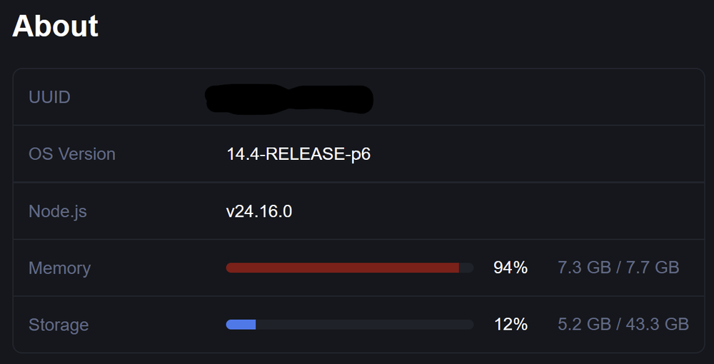

October 9Oct 9 Author 16 hours ago, Guy Lavoie said:Try checking it every few hours, to see if there is a progression.The lockups are unusual. Seems we'd hear other reports if it was an issue with a release.Overnight, memory utilization (as indicated in eisy-ui) spiked to 94%. Less than 0.5 GB remains free per system monitor (189M Active, 700M Inact, 7812K Laundry, 6270M Wired, 465M Free). Nothing strikes me as inherently problematic in that, but it might be notable that someone at UD decided to code the thermometer bar to present in RED rather than BLUE at these levels.Is there something else I should be checking? ... or just wait for lock up and then pull some log?
October 9Oct 9 There are some overnight tasks that might have used up some of the available memory. 90%+ memory usage is what everyone pretty well sees on a running system. A Polisy or a eisy-lite only has 4 GB of RAM and get along just fine.As for the lock ups, do you have any particular plugins or other programming that sets your controller apart?

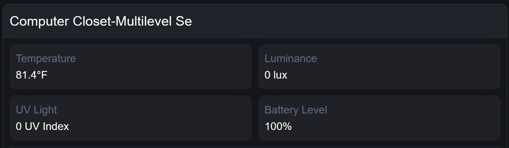

October 9Oct 9 So nothing out of the ordinary.The screenshot in your original post seems to indicate a possible hardware issue with the controller's built-in storage controller. mmcsd0 is normally the primary flash storage. It's as if it was not responding and timed out. Hardware failures are rare, but not impossible. If it was a driver issue (from an update) I would think that others would have reported it.Is your eisy in a confined space? Does it get very hot?
October 9Oct 9 Author 10 minutes ago, Guy Lavoie said:So nothing out of the ordinary.The screenshot in your original post seems to indicate a possible hardware issue with the controller's built-in storage controller. mmcsd0 is normally the primary flash storage. It's as if it was not responding and timed out. Hardware failures are rare, but not impossible. If it was a driver issue (from an update) I would think that others would have reported it.Is your eisy in a confined space? Does it get very hot?It's in a computer closet with a reasonably controlled environment. Current ambient is only 81.4F. eisy itself feels warm to the touch, not hot.

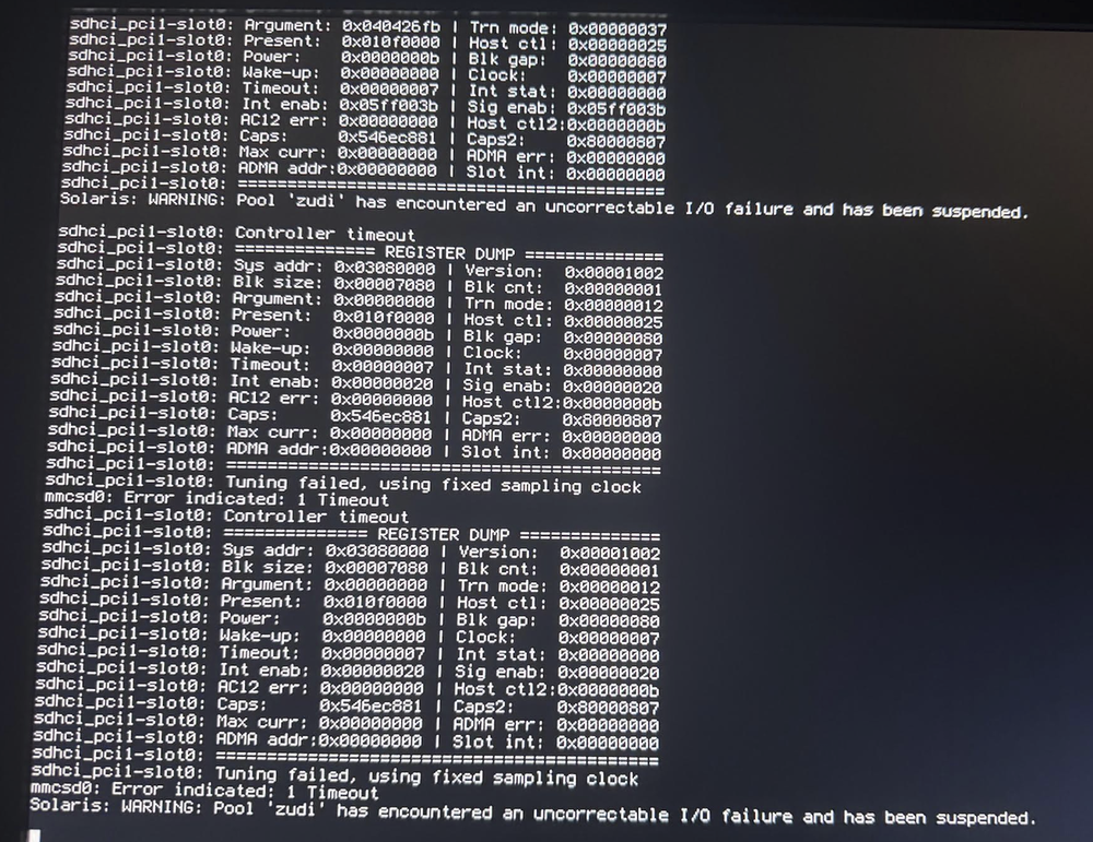

October 11Oct 11 Author On 10/9/2026 at 8:32 PM, Guy Lavoie said:Just for fun, I upgraded to eisy-ui 1.4.2 minutes ago, and my memory usage shows 97%, but the line is blue. I don't know if it's just a change they made to make it feel more normal, or if there's a meaning to the color.Interesting.Another lock-up occurred overnight. I haven't rebooted yet. I need an escalation plan; the repeated hard fails are not sustainable. Does anyone have a suggestion? I will pull a ticket, referencing this thread.The display tail of error messages this morning on console seems the same last two times:
October 11Oct 11 FWIW This is what AI says:This message means that the ZFS storage subsystem on your FreeBSD system has run into a severe input/output (I/O) error that it could not recover from, and as a safety measure, it has temporarily frozen (suspended) all read and write operations to the zudi pool.(Note: The prefix Solaris: WARNING is a legacy artifact in OpenZFS code inherited from its original Solaris roots, even when running on FreeBSD.)What is happening under the hood?The Trigger: ZFS tried to read from or write to one of the physical drives (or virtual devices) in the zudi pool, but the underlying storage controller, disk, or driver returned a hard error (e.g., a timeout, CAM subsystem error, or disconnected device).The Suspension: Because ZFS couldn't complete the I/O operation and couldn't safely bypass it without risking data corruption or silent data loss, it suspended the pool. This stops applications from writing half-baked data or reading corrupted state.Current State: The pool is effectively locked in a read-only/unresponsive state until the underlying hardware issue is fixed and ZFS is manually or automatically signaled to resume.Common CausesHardware Failure: A failing or completely dead hard drive or SSD belonging to the zudi pool.Loose/Faulty Cabling: A loose SATA/SAS data cable, bad backplane, or failing power connector causing the drive to intermittently disconnect.Controller/HBA Issues: An overheating, crashing, or misbehaving disk controller (HBA, RAID controller in IT mode, or motherboard SATA chipset) accompanied by CAM (Common Access Method) kernel timeouts.Driver/Firmware Bugs: A glitch or bug in the FreeBSD storage driver or the drive's internal firmware.How to Troubleshoot and RecoverCheck System Logs for Clues Look closely at your console output or check /var/log/messages right before the error occurred. You will likely see FreeBSD CAM subsystem errors (such as device timeout, ahci reset, or drive offline) that point to which specific disk caused the failure.Inspect the Pool Status Run the following command to see the state of the pool and identify the offending device:zpool status zudiCheck Physical ConnectionsPower down the system safely (if possible, though a hard reboot may be forced since the pool is hung).Reseat or replace the SATA/SAS data and power cables for the drives in the zudi pool.Ensure your HBA/controller is firmly seated in its PCIe slot.Test the HardwareRun a SMART long test on the drives (smartctl -t long /dev/adaX) to check for surface errors or failing hardware.Look for controller firmware updates.Clearing and Recovering the Pool Once you have fixed the underlying hardware issue (e.g., reconnected a cable or replaced a dead drive), you may need to reboot the system or clear the error state to force ZFS to resume the pool:zpool clear zudiIf a drive has permanently failed and your pool layout allows for it (e.g., it's a mirror or RAIDZ), you will need to replace the failed disk using zpool replace.
November 10Nov 10 Author Follow-up / after-action report: after I pulled a ticket, @Michel Kohanim was EXTREMELY helpful. Thank you, Michel. For the community, the issue here was a failed/failing eMMC. The solution involved installing an NVMe SSD as replacement non-volatile storage. Michel guided me in the diagnosis and some post-install cleanup that I needed. All good now and eISY has been stable for about a month. Thanks also to @Guy Lavoie and @hart2hart for some of the initial triage and diagnostic suggestions before escalating to a service ticket.
