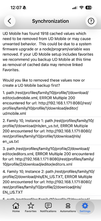

June 21Jun 21 I just downloaded latest version of UD mobile on iOS. I’m getting many errors on sync. It had been great until this version.No control even for Insteon devices I can’t select all the errors but here is a screen shot from top Edited June 21Jun 21 by hart2hart

June 23Jun 23 Will be fixed in next firmware update 966b1b.This is a networking error/bug when requesting Node Server Profiles. Portal Server is catching the issue, app was also caching the issue in the past but this caused slow synchronizations due to iOS not allowing connection-close header.

July 23Jul 23 The app should have prompted to backup before removal, if you did restore the backup.The issue does not require cell service, only that the syntonization is done through Portal. So temporarily removing the local connection from UD Mobile settings will fix, UDM will still uses your home Wifi. The alternate method is to do on cell service which forces a remote connection as not on WiFi.The cause:There were recent changes to iOS (OS) which caused significant hanging in remote sync, part of this was due to UDM trying to catch a firmware bug during synchronization which I thought was fixed years ago but the workaround remained so was no one noticed it was not fixed. When the catch was removed to fix the remote synchonization hang, We noticed the issue was never fixed in firmware. A fix will be in the next firmware version, however because most of our users use the remote sync, it is preferred to not revert the workaround in UDM as sync would hang for most users as they use remote.

July 26Jul 26 2 hours ago, SteveBL said:My EISY totally crashed and I can't seem to restore from a backup to my iPhone.I seem to have lost all devices and programs. I'm totally confused!UD Mobile cannot restore eisy, this can only be done from admin or eisyui (web).1 hour ago, oskrypuch said:Is this an iThingie problem only? That is, is there an issue with the android UD app?OrestThis is an issue with Local synchronization on iOS only. iOS doesn't allow a http header that prevents a firmware bug. So other non-iOS clients are not affected. iOS devices synchronizing through portal are not affected.
