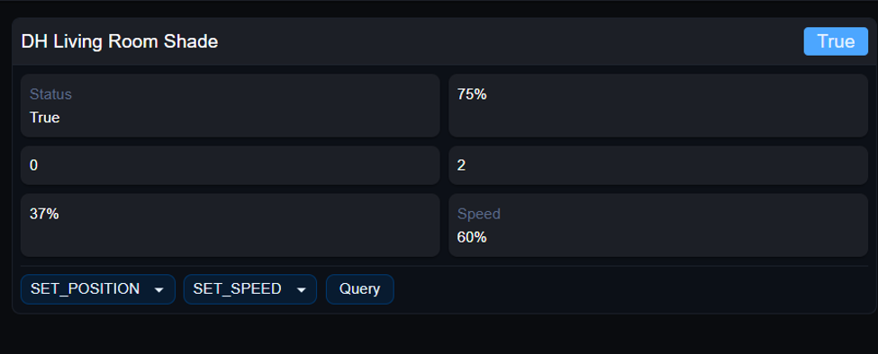

October 30Oct 30 @bpwwer , @JaviAfter migrating Ryse Plugin from pg3x to eisy, the following issues were observed:Several fields in eisy-ui have no labels. They are: Position, Position State, Power Type, Power Level.The label Online changed to Status. With a value of True, I don't think the updated text for the label is sufficient to identify what it is.The label Shade Speed is now Speed.The value for Position State in pg3x was as an example Stationary. Once updated, the value became 0?Only some of Properties labels are displaying in UD Mobile. Properties that display are Speed & Status. The remaining Properties are displayed as: GV0, GV1, GV2, & GV3. I have synchronized UD Mobile, rebooted eisy and synchronized again with no change. Edited October 30Oct 30 by DennisC added missing information.
October 30Oct 30 Looks like eisy plugins isn't seeing the NLS file. That's what defines all the strings for label names and maps the numeric values to strings.I take it a restart of the plugin doesn't fix it? If it doesn't then either the migration didn't fully migrate all files or eisy plugins thinks there's something wrong in the file and doesn't load it. @bmercier @Javi

October 30Oct 30 Author To close out issue with Yolink, restarting or reinstalling the plugin didn't work. I finally rebooted eisy and that did work, so Yolink is running.Still have an issue with Ryse Shades, I can not get the Properties labels back. The plugin has been moved back to pg3, has been restarted several times, and I tried reinstalling the plugin. The Properties labels are still displaying as shown in my screenshots in my first post.@Javi @bpwwer , anyway to get the Properties labels to show as before the migration in eisy-ui or UD Mobile? Will they restore after this is addressed by the next update?

October 31Oct 31 So maybe it's a similar, but different issue.The only way I know of to check eisy-ui is to look at http://eisy.local/api/profiles Unfortunately this is a big XML file. The browser should allow the option to show it formatted and then you have to search for ryse in there. You should find something like this:"nodedefs": [ { "id": "shade", "nls": "shade", "icon": "Output", "name": "RYSE SmartShade", "properties": [ { "id": "ST", "editor": "bool", "name": "Online" }, { "id": "GV0", "editor": "shade_position", "name": "Position" }, { "id": "GV1", "editor": "shade_state", "name": "Position State" }, { "id": "GV2", "editor": "power_type", "name": "Power Type" }, { "id": "GV3", "editor": "power_level", "name": "Power Level" }, { "id": "SPEED", "editor": "shade_speed", "name": "Shade Speed" } ],The name field under GV1, GV2, etc. is the label. If it's there, eisy-ui should be showing it, if it's not, the eisy-ui isn't syncing properly (most likely). You can also check http://eisy.local/rest/profiles. This one should be the same, but comes directly from IoX instead of from eisy-ui. If IoX is correct and eisy-ui isn't, is definitely is a sync problem.
October 31Oct 31 Author Searching for ryse turned up nothing, so I searched for shade instead. It looks to me like the "name" name field is missing from several of the problematic nodes.I appreciate you taking the time with this.

November 6Nov 6 Author After the last upgrade, I have rebooted eisy, restarted Ryse Shade plugin and reinstalled the plugin with no change, I am still not showing all of the property names. Javi has indicated the fix of known issues was included. Any suggestion on what to do next?
November 6Nov 6 The only other thing you could try is to delete the plugin and then install it. I've had to do that before but usually because I'm changing things that get cached while developing a plugin.I have no way to debug why eisy-ui doesn't have the NLS file info, which is what appears to be happening. The plugin sends the file to IoX and that's the last interaction the plugin has with it. This is something UDI will need to track down so if you haven't yet, you should open a ticket.
