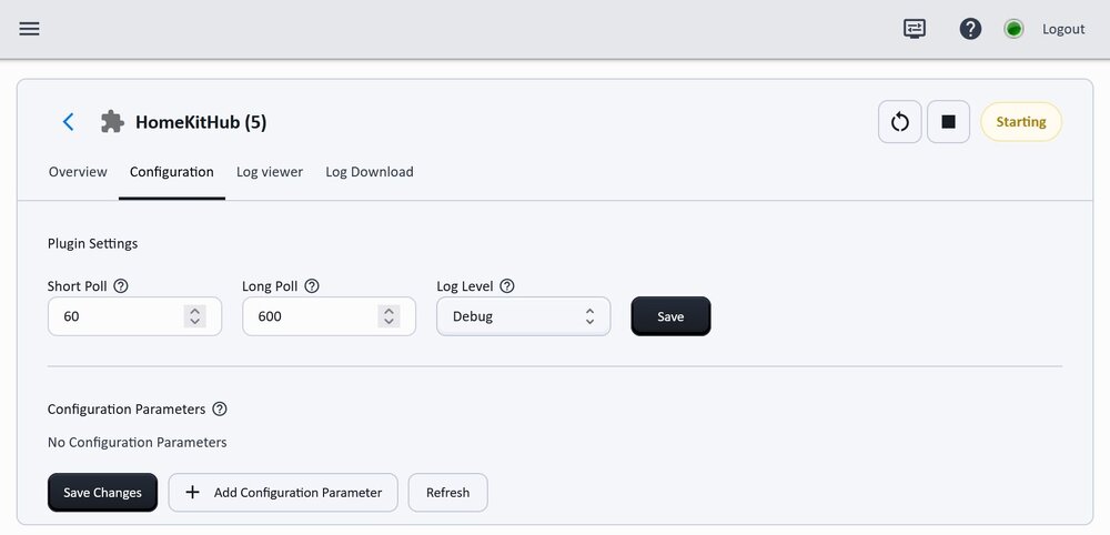

Does this Plug-in install into PG3x or PG3? Every time I see the Home screen it shows me random versions, so I am not sure if this is a problem or why there are two versions showing up. I have been reading github files for hours but nothing seems to work or apply.
I have been trying to re-install, and restart the HomeKitHub many times and no ecobee stat shows up in a list. I have never seen a list, empty or otherwise.
My ecobee shows a small QR code with an 8 digit number but no connection has ever been made, to my knowledge.
HomeKitHub only ever shows CURRENT STATUS: "Disconnectd" in red. I is not clear where it is not connected, ISY or the Stat.

Thanks but that takes me around in circles again. I cannot Discover anything. Reading the github webpages referes me to other github pages that refer me to more github xxx.MD pages.
I am lost. HomeKitHub node always shows "NOT CONNECTED"
I have tried about 5 different ecobee PINS now but I am not finding any title for the PIN. I have been using "hap_pin"

It's a few steps, can you describe which you have done and where the problem is? Make sure to reload the config page as mentioned in #5 (thats a PG3 issue I can't control) and lok under Custom Typed Configuration Parameters for your ecobee.
Quick pairing (DISCOVER)
  1. Add HomeKit Hub from the PG3 store and start the Node Server.
  2. Put the accessory in HomeKit pairing mode (see vendor docs). Confirm it is unpaired from Apple Home and other controllers.
  3. IoT / separate VLAN (optional): only when accessories are not on the Polisy primary LAN — see Discovery networks (setup) below. Skip on typical single-LAN installs.
  4. On the HomeKit Hub controller node, run DISCOVER. Read Notices on the Node Server Configuration page (Custom section): HomeKit discover includes scan results and a Zeroconf / hub diagnostic summary when the new build is installed.
  5. Open Configuration → Custom Typed Configuration Parameters → HomeKit pairing slots. Reload the Configuration page in your browser if the new row does not appear yet (the table refresh button alone may not be enough).
  6. Find the row for your device (id and name are filled in by DISCOVER). In HomeKit pairing code (hap_pin), enter the 8-digit code currently shown on the accessory while it is in pairing mode (12345678 or 123-45-678 — either format works). Save.
  7. Wait for pairing to finish. A Paired HomeKit device child node should appear; ST should show paired/connected. Check PG3 Notices or logs/debug.log if pairing fails.
Order matters: run DISCOVER before entering hap_pin so id/name are prefilled. If you already typed a PIN, clear it, run DISCOVER with the device in pairing mode, then re-enter the current code.

1,2 done, 3 skipped. 4 results in no feedback whatsoever. Am I missing something?
Does the system jumping back and forth from PG3x to PG3 matter? I get a page wanting me to migrate to PG3 or back.
Also, how would I tell if my ecobee is already paired to something? I have no Apple devices.HomeHubDiscover.jpg
Log always shows this file missing despite many UPGRADE PACKAGES completed.
2026-10-18 18:11:32.906 MainThread udi_interface ERROR udi_interface:write: import aiomqtt
2026-10-18 18:11:32.907 MainThread udi_interface ERROR udi_interface:write: ModuleNotFoundError
