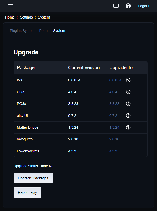

  2. bmercier replied to JSchumann's topic in eisy-ui
    In eisy-ui, go to the upgrade page: http://eisy.local/system/upgrade Click on the information icon to see the changelog.
