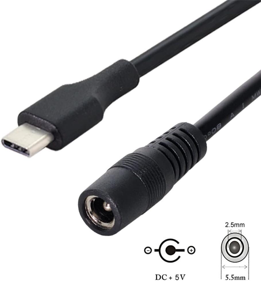

Okay, my solution is in place and seems to be working flawlessly. All I did in the end was buy an adapter cable, pictured below, and connect that to my APC DC UPS barrel connector. This USB C connector is then connected to the power input port on the eisy, not the full function port. I did buy a USB C meter with PD triggering and did lots of testing before connecting my new eisy R2 to the power. It seems to me that the warning about using any other power supply with the eisy R2 is a bit backward. It is the included power supply that should never be connected to anything else. It spits out 12V all the time and ignores all PD protocols. It will have a good chance to wreck anything else you plug it into. But this version of eisy does seem like it could take a PD compliant power supply through either USB C port, but I am not going to be the one to mess with that as my solution works for application very well. Thank you all for your advice and direction.

Further research seems to support that the 12V input port is a hybrid port. While it does not support data xfer, it appears to support the PD protocol. My research says that PD negotiation with this port is optional. It can accept 12-18V without negotiation which is what the included adapter is. The full function port appears to require negotiation as it is expecting 0V before PD negotiation and may be damaged by connecting a dumb 12V supply that is always on. It seems that they did this specifically so that you could power this small computer from a battery or power bank that has no PD ability, as long as it was 12V. Also the range of 12-18V seems to be because lots (maybe even most) USB C power supplies do not support the 12V profile. The 12V profile that was part of PD 1.0 was not included as a mandatory voltage in USB PD 2.0 & 3.0, so now most power supplies jump from 9V directly to 15V skipping 12V altogether. But this learning I have done makes me wonder if the warning label UD put on the device is a leftover from eisy that just came over to eisy R2? It sure does seem like you could power this device from a USB C Power Delivery compliant supply that supports 15V which would be any that advertise as 27W or greater capacity.

This is actually really great info. Yeah the power supply could really mess up another USB C device, but looking at the exact computer on Amazon: https://a.co/d/h0XQsML It looks like the OTHER USB C port is fully PD compliant and can be used as a power input! So for sure I feel like I could use a PD compliant UPS like https://myliontech.com/en/product/mylion-muc66-mini-ups-type-c-pd-65w-in-out-lithium-battery-pack-backup-uninterruptible-power-supply-for-wifi-router/ and plug it into the second USB C port. This is really a great link too. Thanks Brian. Based on this I am first going to try an adapter cable going from barrel to USB C. I am also going to buy a USB C meter/tester and play with that before connecting to my eisy.

Well, ideally for me would be if I could continue to use my APC DC backup. It outputs a regulated 12V up to 3.5 amps on a standard DC barrel connector. This plugged directly into the Polisy. It should be able to power the eisy for like 12 hours or more. So do you think a simple adapter like: https://a.co/d/3PLKt9u Would work? I know 12v is 12v, but my big concern is polarity and the USB C pin out. I would assume this is very common and manufacturers (including Universal Devices) would use the same pins for power, but I also would not have assumed that UD would have a USB C port that does not negotiate using the PD USB standard or at least have a way of protecting the eisy from damage. USB C power supplies are so common I was surprised to see a damage warning on the device with the public having access to such a variety of power supplies that terminate to USB C. So I am just a little scared. Regarding device sync. Yeah, I have a delayed activation relay connected to an I/O linc. 2 minutes after power is restored and stable the I/O linc closes, the ISY sees this and notifies me and does a query all.

Just set up my new eisy R2. I am coming from Polisy so the power supply form factor is different. The eisy uses a USB C 12V port. But the top of my new eisy R2 had a sticker that said to only use the factory supplied power supply as it will be damaged by anything else. What is special/unique about the eisy USB C power input? I thought USB C was generally supposed to be kinda universal and sorta protected? What is special/unique about the UD supplied power supply? The reason I ask is because I have some extensive programing that relies on countdown timers. (long ones) I am coming from the ISY 26 to the 99i to the 994 to the Polisy. With each iteration I have had to implement a new UPS solution to keep my ISY live across blackouts. Each time I have looked at alternate ways of achieving my objectives that are met by my long timers and never been happy with them. I have built further systems and protocols that rely on my ISY always being on. Before I begin looking for how I am going to accomplish a UPS for the eisy R2 I wanted to make sure I would not damage my eisy. I know I could just get a normal UPS and plug the UD 12v power supply into it, but I have always preferred a direct DC UPS. The Polisy ran on a APC UPS Back-UPS Connect CP12142LI : The advantage to this is the device is further separated from the power line, there is no transfer time, and most importantly, without inverting DC battery energy to 120V 60hz AC only to convert it back to DC I realize vastly longer run times for the same size back up battery. Actually, the DC UPSs usually end up being less than half the size of a normal standby UPS. I feel pretty confident that I can find a suitable USB C 12V device that will function as a UPS, but the sticker makes me worried about damaging my eisy.
