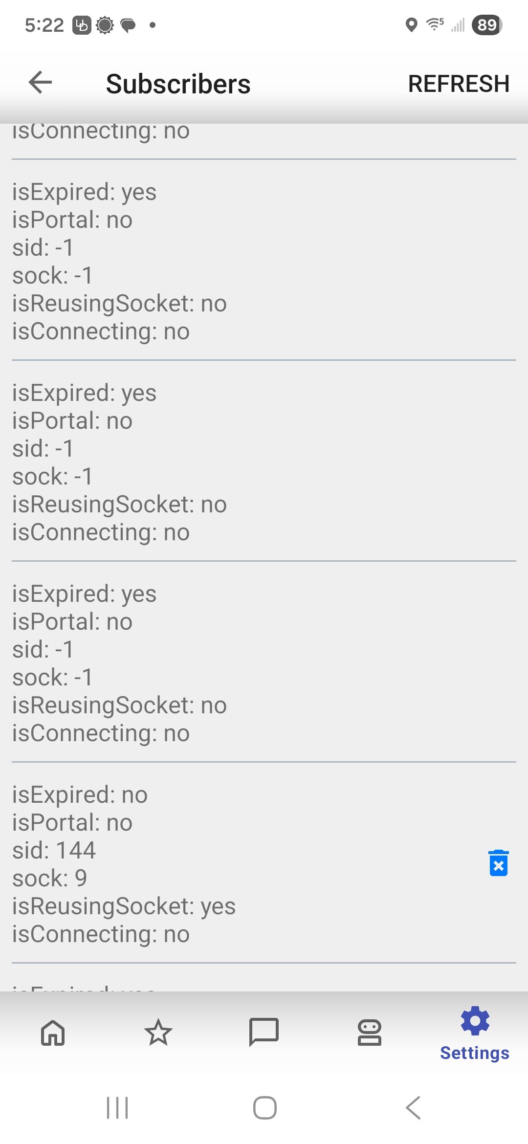

  1. Javi, Thanks for the tip! My Arduino code (ESP8266 actually) is pretty stable, so I haven't had any unexpected disconnects. Currently, upon a disconnect it goes into an infinite wait-loop that is only exited with an ESP8266 power cycle. I will implement an unsubscribe and a reconnect/subscription retry in the next version. I assume you mean that upon a connection loss, I should do an eisy-reconnect, unsubscribe, subscribe - in that order? Keeping track of the old subscription ID shouldn't be a problem. I can packet snoop on udm to see how it does it, if I can catch it resubscribing. I assume it unsubscribes when the app shuts down. Will eisy gaak on an unknown/expired subscription ID if I try to unsubscribe using the one from the previous session? I see 8 or 9 (out of 10) expired subscriptions in udm. Is this an issue?

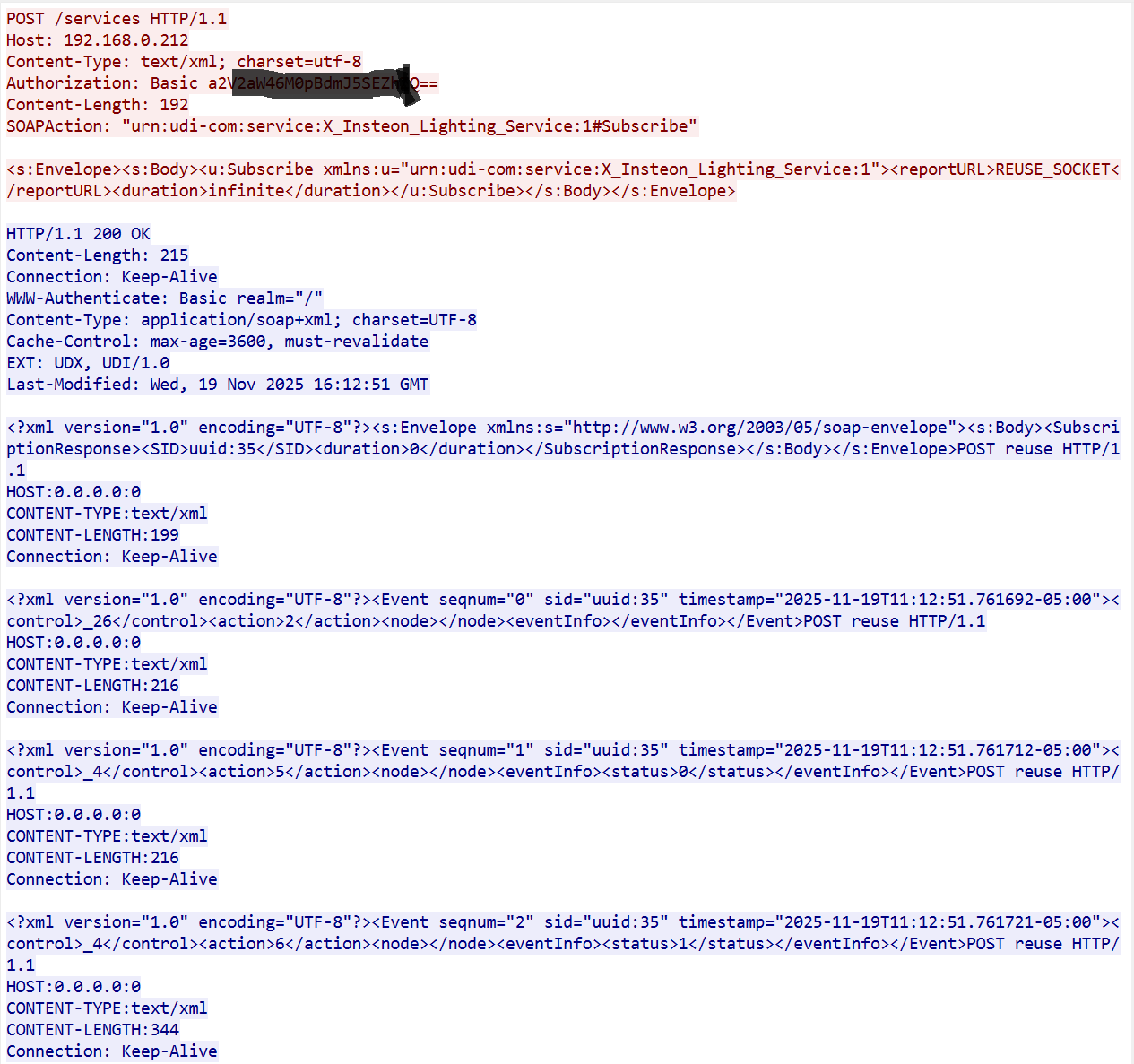

  4. I can successfully subscribe to all events on my EISY but that is not optimal since I have 100+ nodes. I receive a huge dump (212 kB) of the status of every node when I first connect. I am using a SOAPAction subscribe query to X_Insteon_Lighting_Service like so: POST /services HTTP/1.1 Host: 192.168.0.212 Content-Type: text/xml; charset=utf-8 Authorization: Basic MyPassword== Content-Length: 192 SOAPAction: "urn:udi-com:service:X_Insteon_Lighting_Service:1#Subscribe" <s:Envelope><s:Body><u:Subscribe xmlns:u="urn:udi-com:service:X_Insteon_Lighting_Service:1"><reportURL>REUSE_SOCKET</reportURL><duration>infinite</duration></u:Subscribe></s:Body></s:Envelope> Is there some other EISY service name I can use to receive events from only one node? Is there some parameter I can pass to X_Insteon_Lighting_Service that limits events to a single node (like 3C 80 F 1) Note: I am not talking abou PolyGlot/Portal subscriptions. I intend to subscribe to and parse EISY event text on some local hardware running on the same LAN as the EISY.

  6. For the lurkers: I did a bit more research by sniffing the packets generated by UD Mobile that arrive at the EISY network connection. I found that subscribing to EISY events is done using SOAP. UD Mobile starts off by querying the local time on the EISY with a Connection: Keep-Alive. My guess is that this is just a way to get the subscription conversation started since we don't really care what time of day the EISY thinks it is. The red text comes from UD Mobile and the blue text was generated by the EISY. I blacked out my authorization credentials. Now that we have a nailed-up keep-alive connection, UD Mobile subscribes to EISY node events using a SOAPAction call: The EISY replies with a gazillion XML packets that show the status of every node it knows about - in my case, around 100 of them. Last, it sends updates for node values that change. I am currently researching if it is possible to subscribe to a single node instead of doing a core-dump of all my nodes. I don't want to be drinking from the firehose in a tiny Arduino project. I suppose I could filter out all node events that don't match my thermostat node ID.
