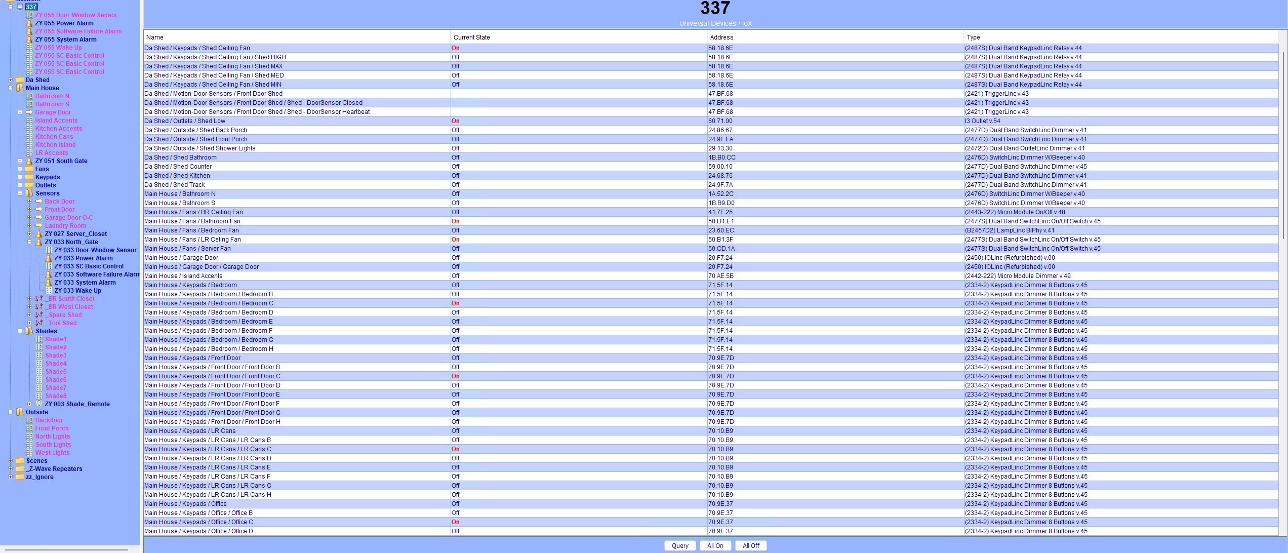

  13. I am using the EISY with UDI ZWAVE module that plugs into the device's USB port, model 21100. I performed factory reset on the AEOTEC device each time I exclude. LEDs indicate that the reset was successful. I have repeated the remove/include process multiple times. Both inclusion and removal are quick. Removal works as expected with all components removed from EISY tree. Inclusion triggers the interview and the result is some subset of the total components of the device showing up, sometimes just the alarm and wake-up, other times (as pictured) with everything except the "Alarm Controller" which is the main component that the subs get nested under when present. Is there a separate option for "exclude" (rather than remove)? Any other tips? Happy to keep experimenting, but I've tried any combination of EISY ZWave menu items I can think of. thank you for your input and info

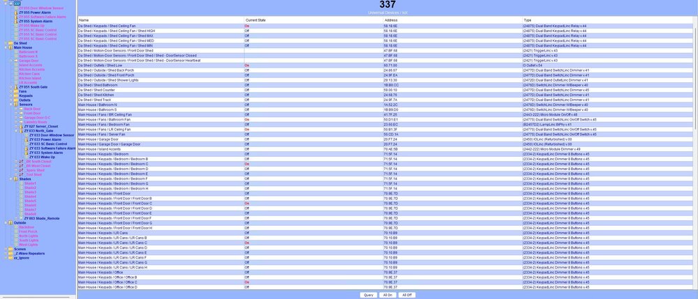

  14. I'm not 100% sure of the terminology, but 337 is the container for the entire network. It is where devices go when I "remove from folder". Edit: screenshot attached
  15. Thanks for quick reply. In this case, I've repeated the procedure 17 times (last device was 033, this one is now 055). I can't really expect any additional iterations to work. Comms don't seem to be a problem, I'm in proximity to the dongle and the add and remove commands seem to be responsive. I've performed factory reset on the sensor multiple times and according to the LED blink sequence, it has been successful. Any idea if factory reset on Z-Wave dongle (ZWAVE->Advanced->Factory reset Dongle) is a good move. Will it remove any devices I have in the network? I also tried the log events during add/remove sequences (ZWAVE->Capture log), but the log was empty of events. Just showing the TAIL commands but zero bytes of logging data. Other than the rubbing belly trick (which I will now try and report back), any other suggestions?
  16. Have I posted to correct forum? Please direct me if not. TY Hi All, I have a few AEOTECT recessed door sensors and have always been able to get them discovered after a couple tries of adding and removing the device. In this case, I have two new sensors and no matter what I can think of trying, they show up as "ZY049 V1 Alarm" with sub-device "ZY 049 Wake UP". I expect to see the Door-Window Sensor, the Power Alarm, etc. (screenshot attached showing the new device at top, and existing device ZY 033 about midway down the device list. I have recently upgraded EISY to 6.0, but can't find anything in release notes to support the problem I'm having. I have Z-WAVE module 21100. A few notes: EISY occasionally hangs when I attempt to "Update with Interview", only hard reset brings it back (this problem is secondary) Java is updated to v8 build 471, but problem occurred before java update (cache was cleared) Other Z-Wave devices in the EISY work fine, including a sensor with same firmware and model Two different new sensors exhibit this behavior Looking for any help. Thanks folks. :walkman99
