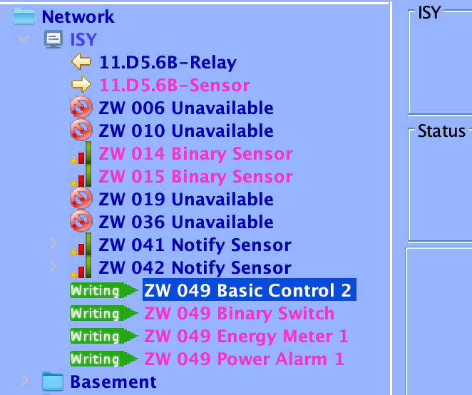

  24. Tried deleting and re-adding the module in close proximity to the ISY. Same behavior. Once added, do ZWave devices update without being in linking mode?
  25. Just to be clear, the entities for the module were created and everything looked like it completed. But after a few minutes, the <Writing> icons started to show up.
