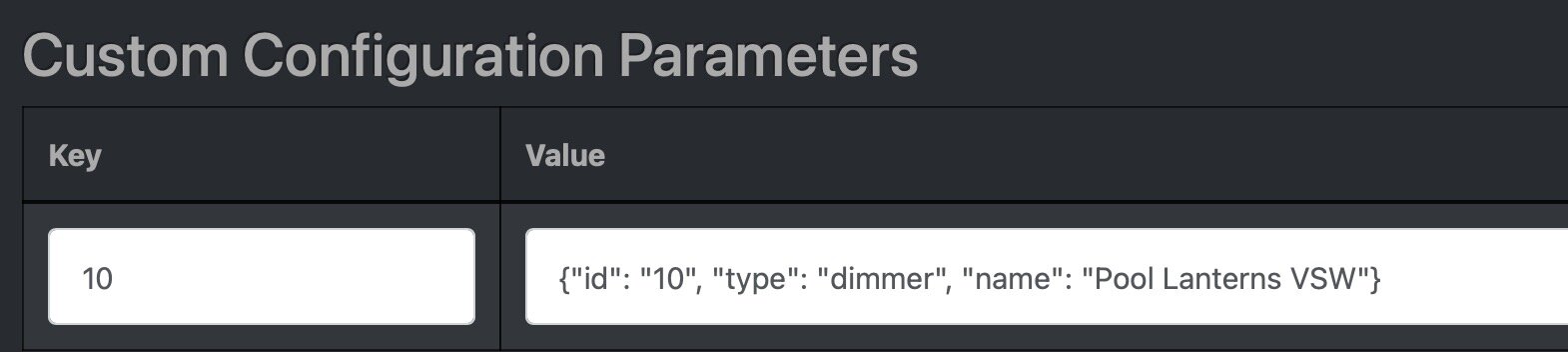

  1. Following the tutorial I found here, I managed to beat my new configuration about the head and shoulders enough to get the Virtual Controller and my generic dimmer to go visible in Admin Console. Success! I had two questions for those with experience in these switches, as virtual dimmers don't seem to present exactly as physical dimmers do. First, the syntax allowed in the program is different for the physical and virtual dimmers. The physical dimmer has controls called Fade Up, Fade Down, and Fade Stop. The virtual one has Brighten, Dim, and nothing comparable to stop. Is this expected? Second (and this seems to be a quirk of MobiLinc Pro only) the brightness reported for this switch is fugazi. On is 40%, whether I turn it on directly or it inherits from the scene when the driving device is 100%. Brighten takes it from 0% straight to 40%, Dim does nothing. Did I define the dimmer incorrectly or incompletely? (EDIT: to be clear, the values shown in Admin Console make perfect sense; it's the values shown in MobiLinc Pro that are wacky.)

  3. Well, that pushed the project ahead. It let me install Virtual, and now Admin Console has new virtual thinginess in the menu. Now I gotta read up on what it expects me to provide for addresses, etc. so I can create one. Thanks a bunch, @DennisC !
