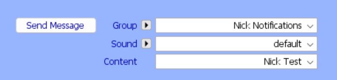

  1. I just double checked. I did follow those exact instructions to setup the notifications. The default group always worked just new groups would not. I just deleted all the groups but the default. Restarted everything. Recreated the groups and then restarted again. now it WORKS!. I would have to go back and add it to my programs and test further but it appears to be working now. If I figure out what was different I will post it for others but I am positive I did all the same steps the first time except the delete part. Thanks all for the help!
  2. I continue to test with this since no one has responded. I can target the group using Configuration->Networking->Network Resources. I found that in the help using this line in the body. title=Test Title&body=Test Body&groupid=Nick Notifications. This is a bit of a pain but it works. I really wanted to just use the group as a target like this test under the Notification Controller attached. But as stated above default sends to all and if a group is selected no one receives the notification.
  3. Is there a doc on this? I setup my groups in the UD Mobile App. I added the devices to the groups. I then started the Admin console and the groups do show up. I created a few notifications. The results when they run. All devices receive the alert if I use the default group and I should mention I removed devices from this group. If I select a new group I created no device receives the alert including the one device that is in the group. What am I doing wrong? I do not want all devices to get all alerts from eisy.
