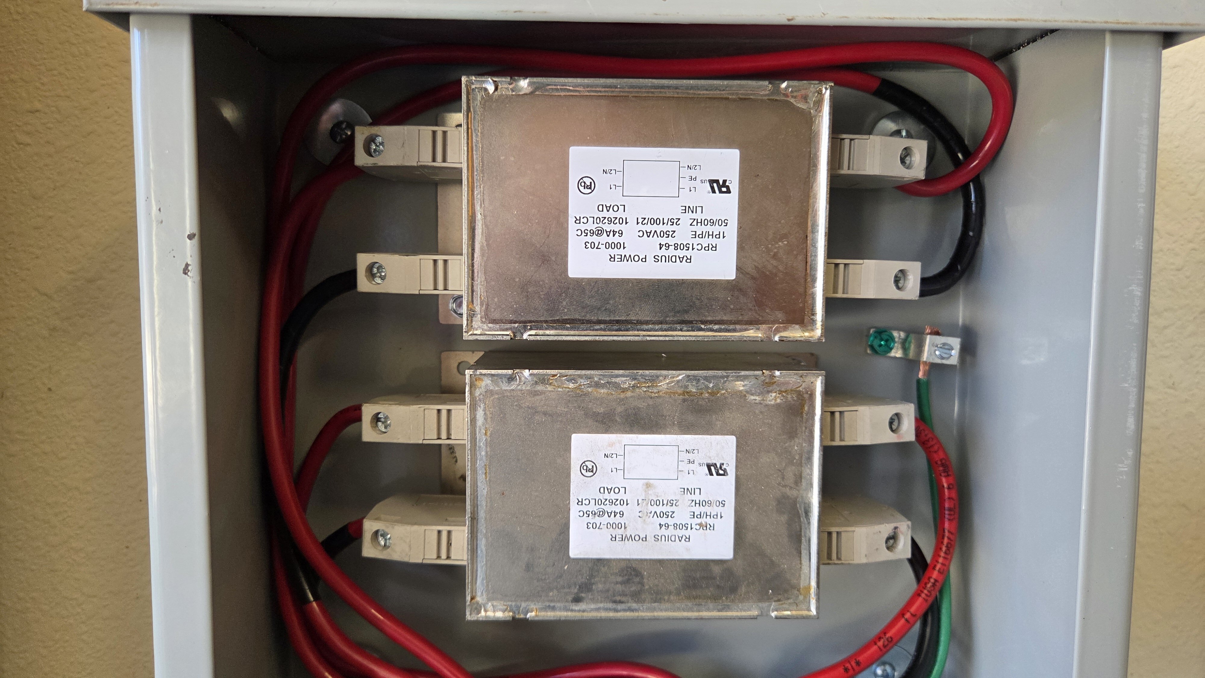

  3. Just thought I would give an update to this adventure. As you may recall, I had 2 Powerwall 3's along with 2 Gateways installed. Almost immediately, I experienced flickering of all lights (LED) that were connected to Insteon dimmer switches. That is when I came to this forum. We tried the Ferrite Cores primarily they were the least cost (my installer was trying to look out for my wallet). They really did not work Last week, we installed the EMI filters that hopefully will show up in the attached picture. Immediately everything went back to normal. Flickering disappeared, scenes programmed into the eisy started funtioning again as programmed and expected, and accessing devices in my eisy network could now happen again. So, I would say mission accomplished. If you want to know more, my installer is Good Faith Energy in Addisson, TX. Amanda Haines was my project manager. Apologies - they were installed upside down from the label standpoint and I was too lazy to rotate the photo. BTW - These are the same filters discussed by NCSTATE1978 is the early days of this topic thread.
  4. We tried the Ferrite Core solution. It helped a little bit. We could see slight improvements on the O-Scope, but the flickering still is happening. Sometimes my scenes works as scheduled. Just completely random. We have ordered the filter that was referenced in an earlier post. The installation is a little bit more involved than the Ferrite Cores. No problems with any electronic devices in the house. TV's, AC units, furnance, tankless hot water heater, Mesh network, internet, ..... are all functioning as expected. You might want to shut your PW3's down. After doing that all of your Insteon and eisys devices should function normally. That will verify the PW3's are interfering with the nornal sine curve of the electricity in your house. Insteon devices according to my conversation with the engineers there like the sine curve to between 59.5 - 60.5 Hz. The stuff coming out of the PW3 was around 62.5 Hz. The only time everything appeared to function normally with the PW3, other than when I shut them down, was when the Severe Weather mode charged all my PW3's to 100%.

  8. @NightStorm If you "talk" to NCSTATE1978, he will tell you the inline filters completely solved his problem. Right now, my installer (in the DFW Area - Good Faith Energy) is getting ready to install the Ferrite Core solution. I am keeping my fingers crossed. The cost will definitely depend on your installers labor cost. The materials for the Ferrite Core solution are about $400 and the In-Line filter (look in the NCSTATE1978 post for the part number) will run about $900. The in-line filter will require about 3 hours of labor whereas the Ferrite Core labor is about 1 hour. There are some additional materals needed for the In-Line Filter. [Numbers assume a 2 PW3 installation] The blinking or flickering is rather annoying. It only affects my dimmer switch installations. What is really annoying for me is not knowing if the programs will function as they did before PW3. Plus, you can not diagnose anything because the communication timing is all our of whack. I had some earlier Lutron devices, but really was not impressed by them. I am sure they have improved since then. I am considered some of the Z-Wave/Zigbee/Matter devices for outside. However, I really am dependent on scene programming. You can turn off your batteries to make sure everything really is working and perform a diagnosis. Keep working with your installer. Show them this thread. I will say the minute I sent this thread to my installer, it went private or required a login.
  9. No. One of the engineers with my installer has been working with Tesla on this very issue. He, along with Tesla, developed a Ferrite Core, similar to one discussed in this thread. They are familar with the Enphase In-Line filter that was the solution for NCSTATE1978. Right now, they are working on estimates for both solutions. I want to know the difference in the labor and other materials since they did say they would refund the cost of the Ferrite Cores if those did not work. They are leaning towards the Ferrite Core since it has been successful in a couple of other installs. However, I do not believe the other installs had INSTEON or EISY as part of the environment. Just dimmer switches. As far as I can tell, Tesla is aware of the issues and has not said anyhting about voiding the warranty.
  10. @jkraus I did a little Google search using RPC1508-64. Several good hits. The Enphase page gave me a price around $420. There were some imdependent sources that were around $350 and EBay source in the $230 range. Obviously, there were would be an installation charge and electricians are not cheap. @NCSTATE78 Thanks. Strange that my installer (who does not have a forum id/pw) can no longer see this thread.
  11. @NCSTATE78 I know it sounds like I am stalking you, but you appear to have solved the problems that I am also experiencing. Currently, my installer is recommedning a Gapped Ferrite (65 A) filter on 4 lines. If I recall correctly, this was a "solution" that sort of worked, but not completely. Is there an way for my installer to contact your installer to discus your specific installation to see if we are similar. I wish I knew of a way to Private Mesaage you so I could give you my email address so we could exchange the information that would better ID us for the installer communicaiton. Thanks
  12. NCSTATE1978 on page 4 of this disccussion gives an image of the Enphase filter that solved his issues, which were the same as ours (blinking and communication lag)..
  13. @NCSTATE78 Thanks for the quick response. My installer is also an ENPHASE installer so this might be a quick resolution. I am getting ready issue a "trouble ticket." I gave them the link to the forum topic chain so they can see all the discussions on this topic.
  14. @bigDvette @NCSTATE78 Do you think the install of the ENPHASE Filter and/or Whole House Sure Protector provided the solution for blinking and communication issues?
  15. Thanks for the update. I will talk to the installer tomorrow. In this thread there appears to be a couple of viable options. My electrical system has 2 breaker panels. One panel is for all of the wall outlets and one is for all the switches. There is a Surge Protector (did not see a model number) with 2 indicators labeled Line 1 and Line 2. I am assuming that is handling both panels. One of the other options talked about an Enphase Filter that sounded like it solved the problem.
