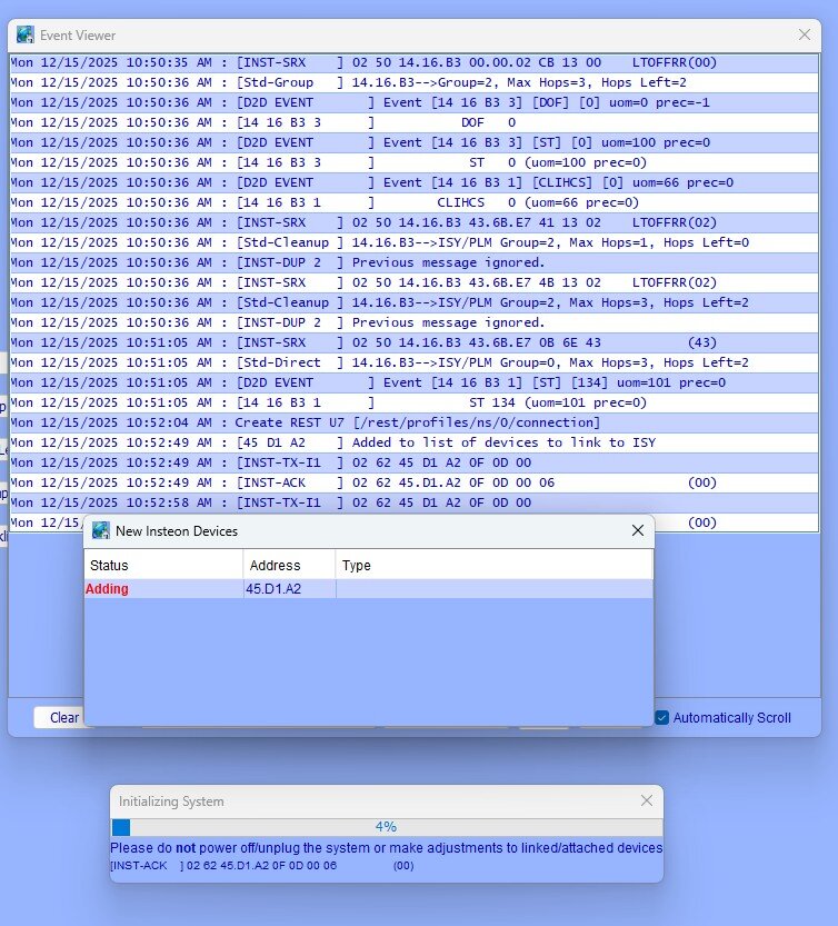

  1. Thanks for all the advice. I tried the technique oberkc recommended (hadn't done it that way before). It didn't work either. Also, this is a brand new MSII right out of the box. Also dleted java cache. Now when i launch IoX I get these windows:
  2. I cleared the event viewer and used auto discover as you suggested It looked like it would add the MSII Then it quickly timed out... My MSII is sitting on my desk 15" from my PLM
  3. Double checked the address. Had it correctly.
  4. I did a factory reset. I tried manually adding using both 2844-222 device types [10.16] [10.18] Still no luck. Same error message.
  5. I plugged a usb cable in for power to eliminate a bad battery. The motion sensor is a few feet from my PLM. I held the set button until i heard one beep and got a slow flash. Still got the same error message.
  6. Model 2844-222 When I try to add I get this message: Cannot add device Cannot determine insteon engine
