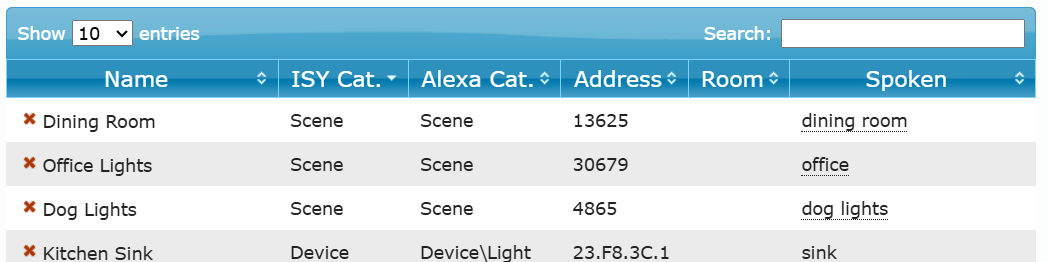

  8. Update. Changed the spoken word from two words to one and it works fine.
  9. Thanks again for your help. The scene is in Alexa. The spoken word still did not work but I made a routine, and it worked as you suggested. I just wish I knew why the spoken word is not working. I understand there were some changes that might have affected older Alexa's earlier this year. Our older devices all seemed to have poorer response to our voices around the middle of the year and practically overnight.
  10. Thanks for all the replies. I have tried the above ideas, tired renaming the scene too, re-ran discovery a few times and it just won't respond. However, I have three scenes and the two most recently added do not work. The oldest (+2 years) does. I think I'll just have to go old school and turn them off by hand.
  11. Thanks so much. Very helpful. So I have the scene set up in the portal and the spoken word identified. Now what I get from Alexa is "dining room is not responding. Please check its network connection". Nothing happens with the lights upon the spoken word. Frustrating as all the other spoken word command's function well.
  12. Thanks for the reply. At the moment, I only have the scene active in my IoX admin console. In my Alexa app, I’ve had the UD “ISY Optimized for Smart Home V3” skill enabled for years, I've also run the device discovery command. Not sure if that helped. Voice control of the scene worked fine when it included just one switch. However, after adding a second switch, it's that second switch that does not respond, while the first continues to work as expected. Since there’s usually a considerable gap between when I use the admin console or add new switches, I don’t always remember the optimal setup process.
  13. Thank you for the reply. This keypad is at least that old, likely a few years more, so this well might be the situation as everything else with the keypad works well. I'll tag this keypad for an upgrade.
  14. I have two Insteon on/off lights in the same room. Using the admin console, I created a scene with both lights in it. In the notes section for the scene, I designated a spoken word. Only one of the Insteon lights responds to an off or on command, spoken via Alexa (using with the set spoken word of course). I do need both to respond. Anything obvious I am missing? Do I need to refresh the Alexa app? Thanks.
