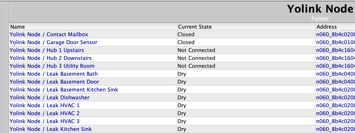

I also like the ability to see this without having to dive deeper into the UI.  One odd thing I noticed is that the current state of my Speaker Hubs always show as "Not Connected", even if the individual devices seem to be reporting changes.
I'm running IoX v6.0.0, with PG3x v3.3.22, and Yolink Plugin V1.5.15.
