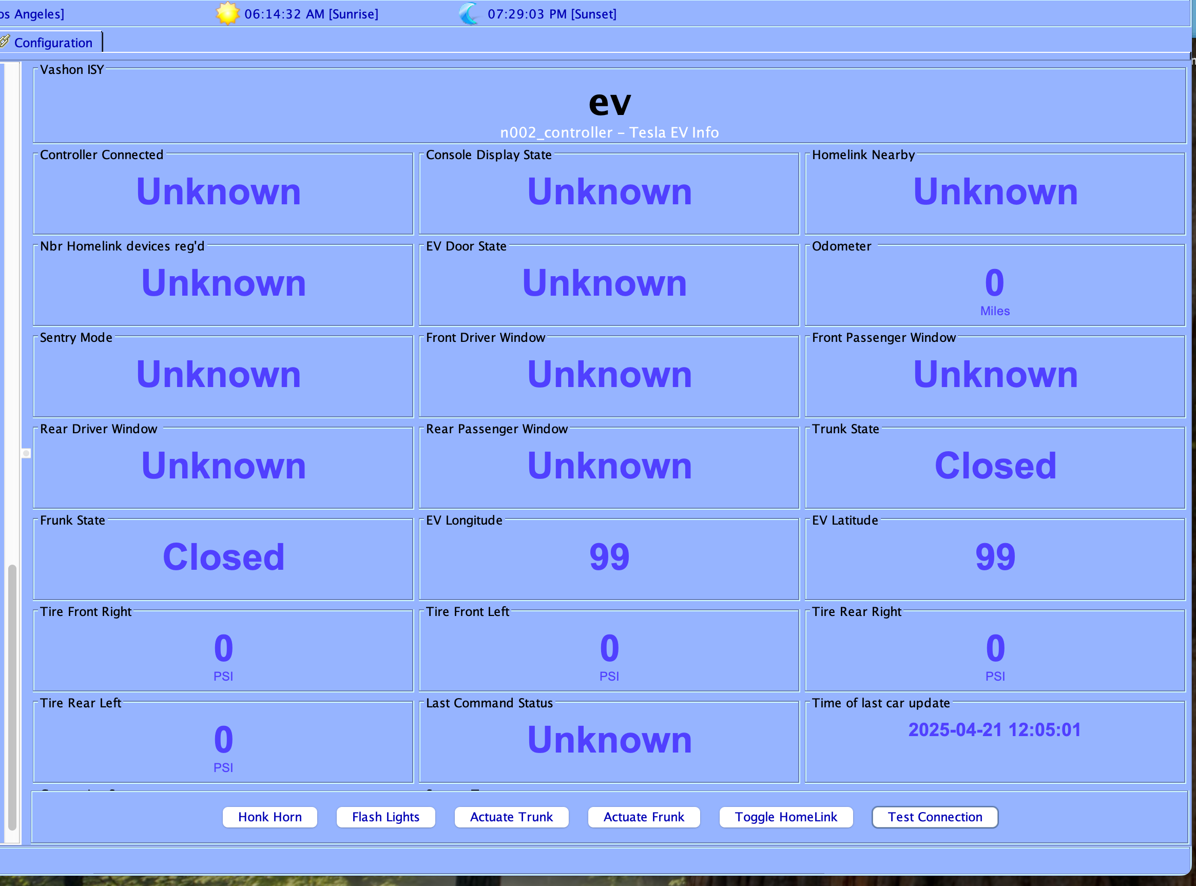

Here are the latest screenshots.  Not much has changed.
Can you run the test button - the results shows below the time on the main page - did you enable access as described in the readme through ISY portal - Also - send me a new log with more data
you have to scroll down to see the result of the test
Did you do the following to enable webhook - It looks to me webhook is not working

Just did this.  Just after re-start, I lost all nodes on plugin.  Re-did test on AC which connected successfully, but had to run authenticate again to see nodes in plugin.  Still no data.
TeslaEVpwrSh_4-24-2025_71843_AM.zip
I need a little more of log time - log stops before data starts to flow
Do you have a firewall that can prevent the communication?
It looks like it is working but I need more time from log - it can take a few mins before data starts flowing - it seems like it passed the test this time
It seems your car or FW is too old (not supported) or the key is missing
'response': {'updated_vehicles': 0, 'skipped_vehicles': {'missing_key': ['5YJSA1E44GXXXXXX'], 'unsupported_hardware': ['5YJSA1E44GXXXXX']
