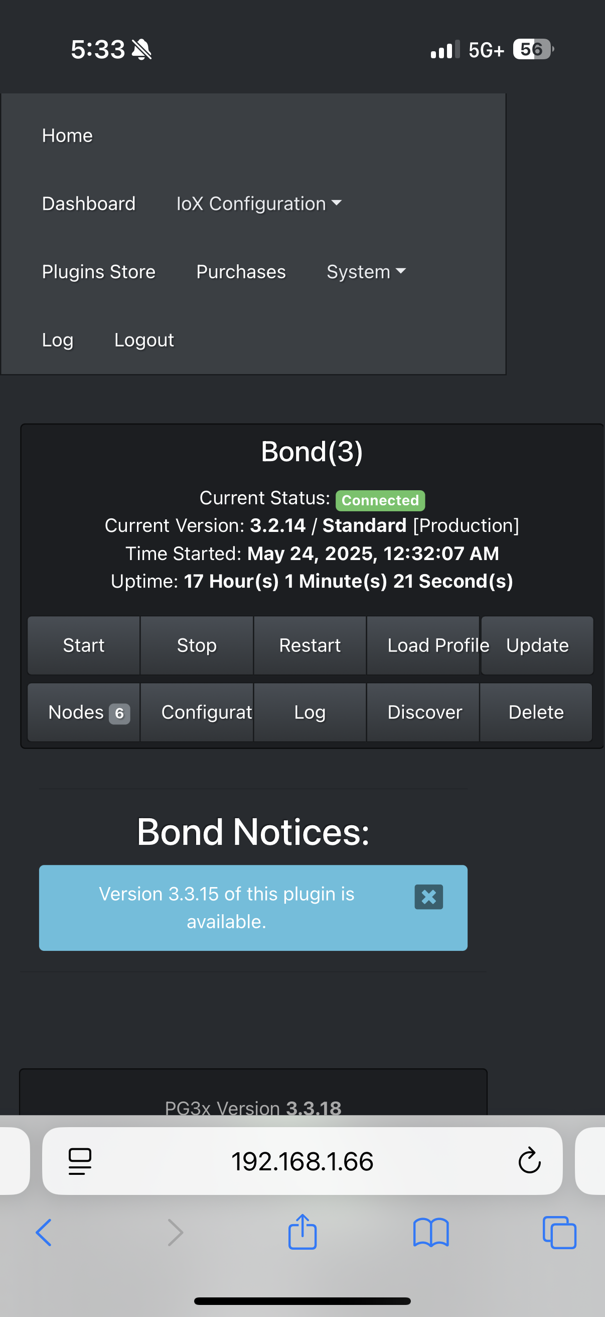

After upgrading to 3.3.15 PG3X still shows the version as 3.2.14. and the blue bar showing an update is available is still present.
I only use the Bond Bridge to control some deck lights, but after updating I am also seeing the issue of PG3X showing the old version is still installed and an update is available.
11 hours ago, JBalog said:
For me it also does not say the [plugin’s] updated
I’ll take care of this in the patch. Let’s see what else shakes out this week.
