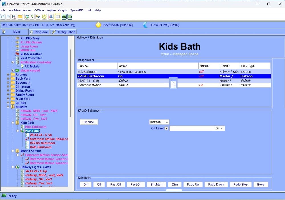

I currently have a program that updates an Insteon switch level from 100% in the day down to 40% at night.  When I manually turn on the light with one of my 3-way switchs attached to that light in a scene, it works correctly.
I recently added a motion sensor to that same scene, but the dimming level no longer changes at night and is always at 100%.
I am not sure if I messed something up when adding the sensor to the scene or something else happened.
Should I have the program change the on level of the scene rather than the switch that the load is attached to?  Maybe I need to do both?  I am not sure how to adjust the on level of a scene in a program as I tried to add this to my then line but could not find the option to adjust the scene's on level.
ok, I figured out how to also adjust the scene to on level 40% as well.  After updating and saving the program, which I am guilty of forgetting to do, the motion detector still turns on the light to 100% and when I manually turn it on it goes to 40% so I have no idea what I am doing wrong.
When I look at the scene, I see the program had set the light to 40%, But if I highlight the controllers, the action still says Insteon On Level 100%, with the exception of the actual switch with the load on it.  The switch with the load on it only says Insteon On Level is "On" so it can use whatever the saved on level of the switch is.  All of the others allow me to select an on level of 0 to 100% but not "on".
I think I have some misunderstanding of how to properly configure scenes.
The switch "Kids Bathroom" has the load on it and gives the option to set On Level to On.  All other controllers in the list force "Kids Bathroom" to be a set On Level, such as 100%, which I assume overrides the program.
Scenewithswitchhighlightedthathastheload.thumb.jpg.890080a7cc4cb00d9e29c045069dd653.jpgScenewithswitchhighlightedthatdoesnothaveaload.thumb.jpg.2e553873e0b989a0a2b6f2355cbde1c0.jpg

well the first line in the than
        Set 'Hallway / Kids Bath / Kids Bathroom' On Level 40%
is setting the switch on level to 40% and works for manual pressing on the button
The second line
        In 'Hallway / Kids Bath / Kids Bath' Set 'Hallway / Kids Bath / Kids Bathroom' To 40% in 0.1 seconds
Is adjusting the scene to 40%, but I just noticed the controller parameter, so maybe I need to add a line for each of the controllers in the scene, to adjust the on level to 40%
Now I specifically set the motion sensor as the controller that adjusts the scene.
I can adjust the if statement, but that part is working as it as I see it working when I manually press the switch rather than letting the motion sensor trigger it.
Edited by epete
So, what I was missing in Scene configuration is that the scene can have a different action depending on what Controller is triggering the Scene.  So specifically setting an action for the controller that was not working as I expected it to fixed this.
