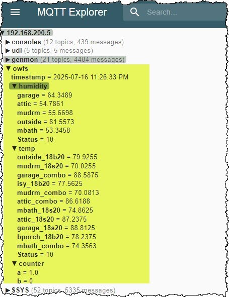

2. I have an RPi running OWFS for a series of 1-wire devices (humidity & temperature sensors and a counter).  I modified a MQTT python script to read the values from the OWFS system and post them to an MQTT Broker as strings.  Below is a screen shot from MQTT Explorer showing my 1-wire sensors.  My script only posts the string values representing the numeric data for each sensor.  What Type should I use to display my string data?   I have tried analog, temp, and raw but cannot get the values to appear in ISY.

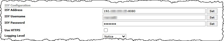

Yesterday I migrated my ISY-994i over to an EISY.  I had previously used a PG1 level node server called NodeLink to communicate with my OWFS (OWLink) and my GenMon.  I was under the impression that these would NOT work in EISY and PG3, which is why I was trying the MQTT node server.
However to my surprise, I found that if I added the port (:8080) to the end of the ISY IP address, the old NodeLink node server started communicating with PG3 and EISY as an unmanaged plugin.

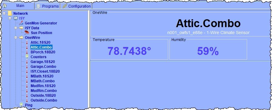

Below is a screen shot of an Attic humidity and temperature sensor in EISY.
