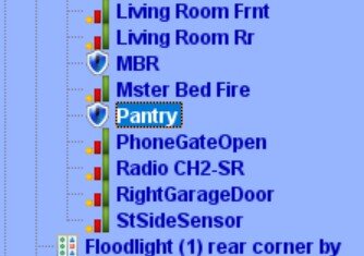

If it were that easy, I would have discovered it by now.  I don't see keypads, but I see the keypad location, but I can't expand it.  See attached image.  And yes, I restarted the plugin and the eisy.
Not sure I understand what you are trying to expand?
There is nothing to expand. When you click on the keypad in the left hand tree, the right side populates with 3 or 4 nodes - no different than a zone or Insteon device.
When selecting the keypad, does anything show up on the right side?

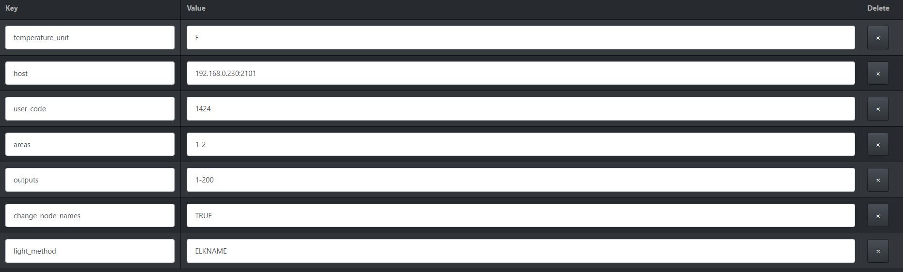

I got the eisy Elk Plugin configured.  The Elk configuration is shown in the attachment.  I still don't see the two outputs I configured in RP2.  And yes, I stopped and restarted the plugin, and rebooted the eisy.
