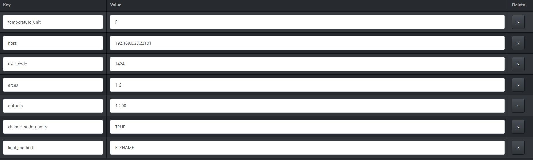

I am getting the attached message (Starting a Subscription).  The message never goes away and it is holding up the eisy..  Attached are my Elk plugin parameters.  How do I get rid of this message?

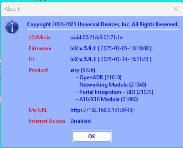

CORRECTION: I launched the admin console again to get the firmware and UI version, and was greeted with the same message.  I couldn't do anything with the admin console until I clicked the X and then it asked me if I wanted to run the admin console.  I clicked the YES button, and the admin console came up.  The relevant info is shown in the attachments.

This doesn't help at all. Imagine reading this months from now and the version is a completely different number than now and somebody thinking whatever ends up resolving your issue would work for them since they'd be on the "latest firmware". Thanks for including a screenshot though showing you're on 5.9.1.
