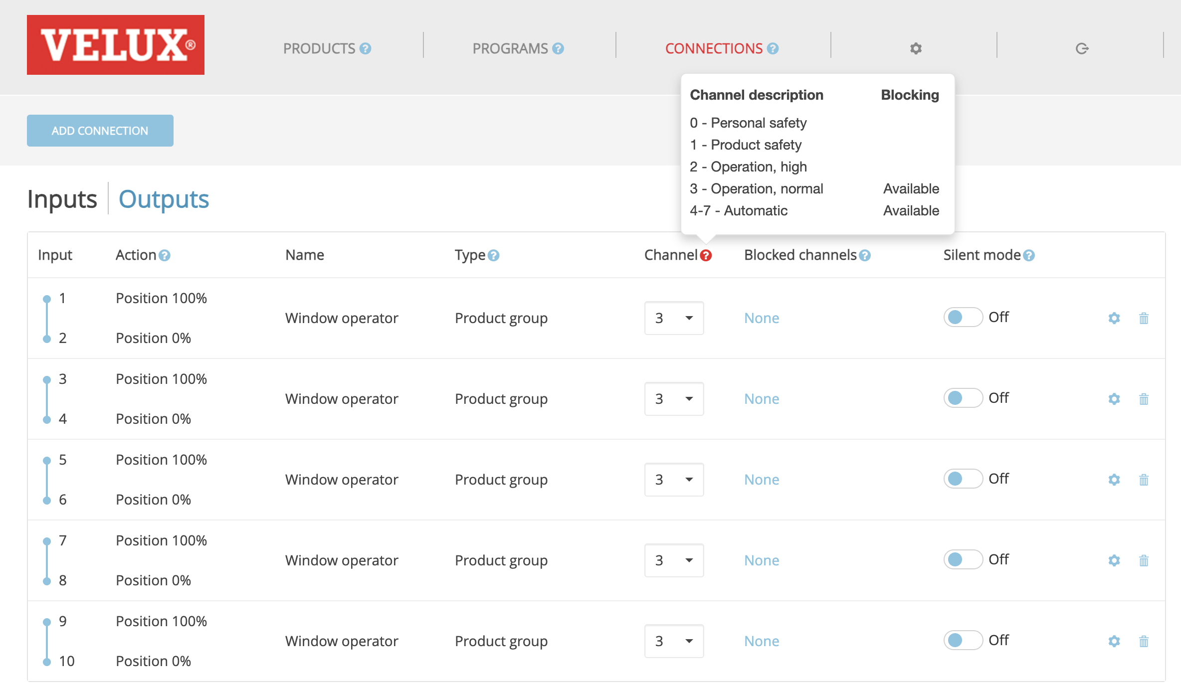

Follow-up to my own post - I got the KLF200 to work. On the web configuration, there's a page where you can assign product(s) to input wires:
You can't see it here, but on the 5/6 input pair I've got two window openers controlled (would have to click the wheel to see and change that).
But, there's also a "Channel" selector. By default, it's using Channel 3, which is "normal operation," but it looks like I could select 4,5,6,or 7 to get different operation behaviors. That might be a way to have more than 5 controls, but it wouldn't be useful for most things as if you can open a skylight you'd also want to be able to close it.
Anyway, I can now use relays in Eisy (Insteon or whatever) to open/close my skylights.

The KLF200 can handle only 5 devices/scenes/groups that require up/down or open/close control. There are only 10 input contact closure wires after all. The default is that when you pair a skylight, one wire opens and the next wire closes it. So with 10 wires that gets you to 5.
Now, instead of controlling a single device, there is the concept of groups. You can program a single Velux remote (KLI) to control multiple skylights or multiple shades. One set of KLF200 wires can control that whole group as well, but not the items in that group independently.
