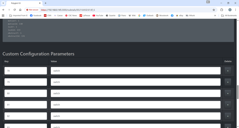

thanks @Guy Lavoie ,

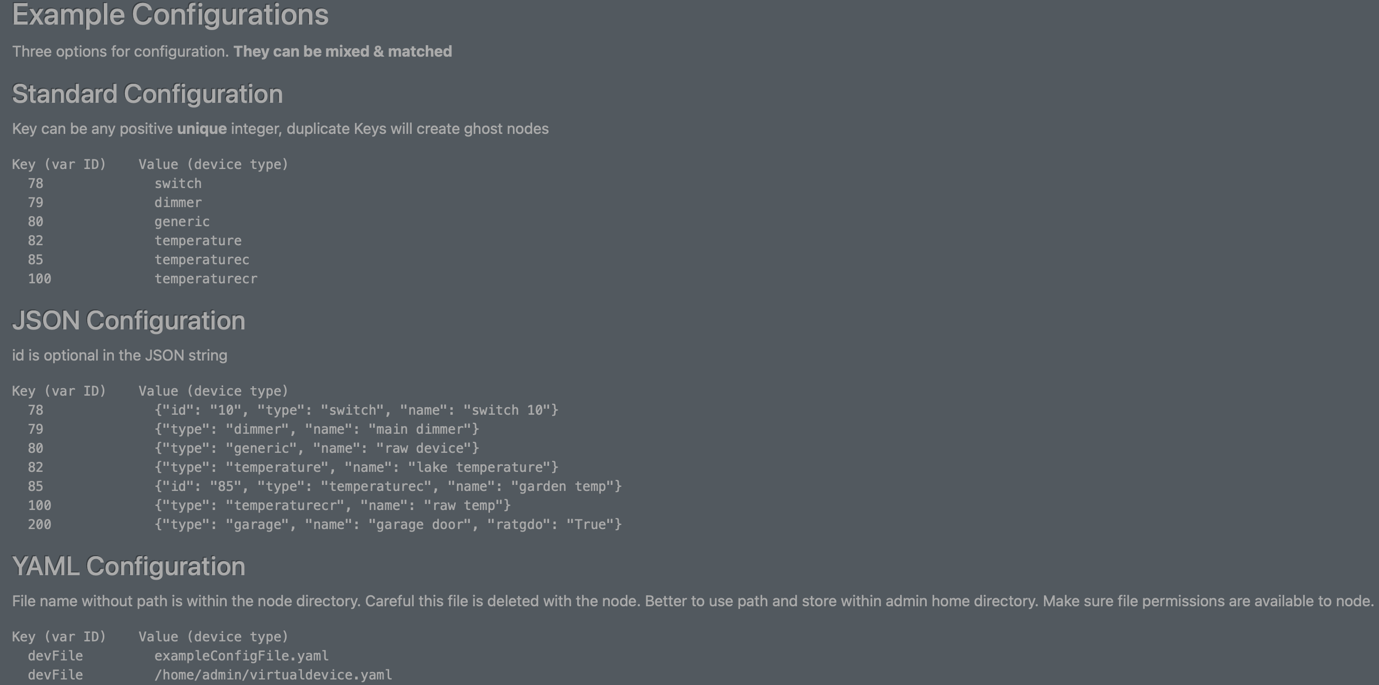

@DonM  there are three different ways to config virtual devices:
1. standard: the way guy shows above, which is the most simple.  put a number for the key and type of device, like switch in value
2. json: a json string which describes the devices
3. yaml: a file which describes the devices
hit the button for configuration and scroll down, it should describe all of them.
(screen shot below)
once you do that you should NOT need to do anything in the admin console to add the devices, they will be added automatically
Thanks, that's solved my problem. I realize that I would have to add them through the plug-in but not through the AC.
It's also important to note that if you were already in the Admin Console when you configured the devices in the plugin, you need to log out of Admin console and then log back in again to properly see the changes.
