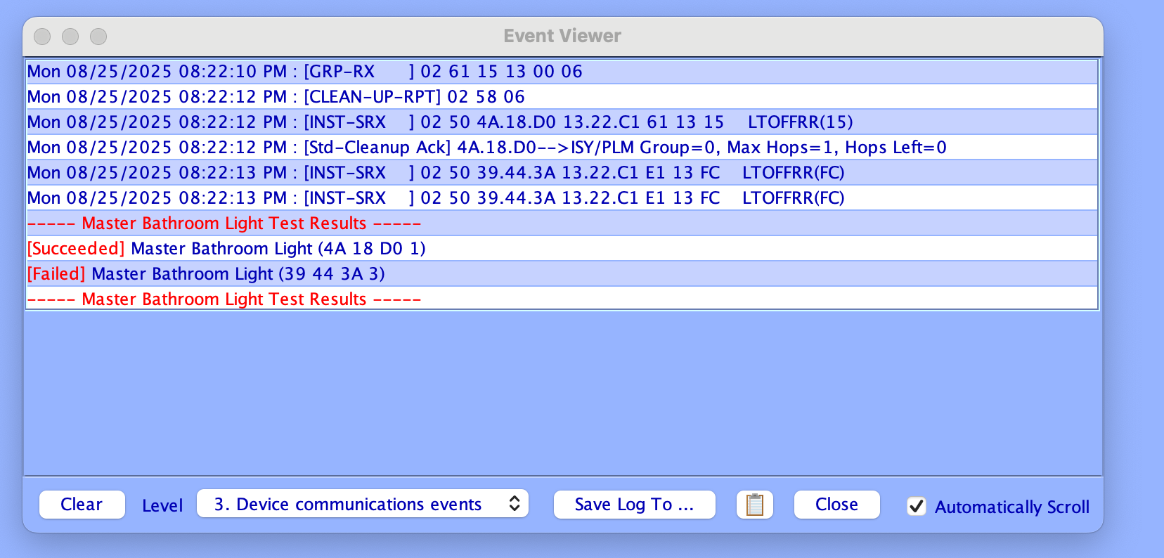

You can start wirh scene diagnostics, right click on the scene then click on Diagnostics | Scene test
Post a screenshot of the results

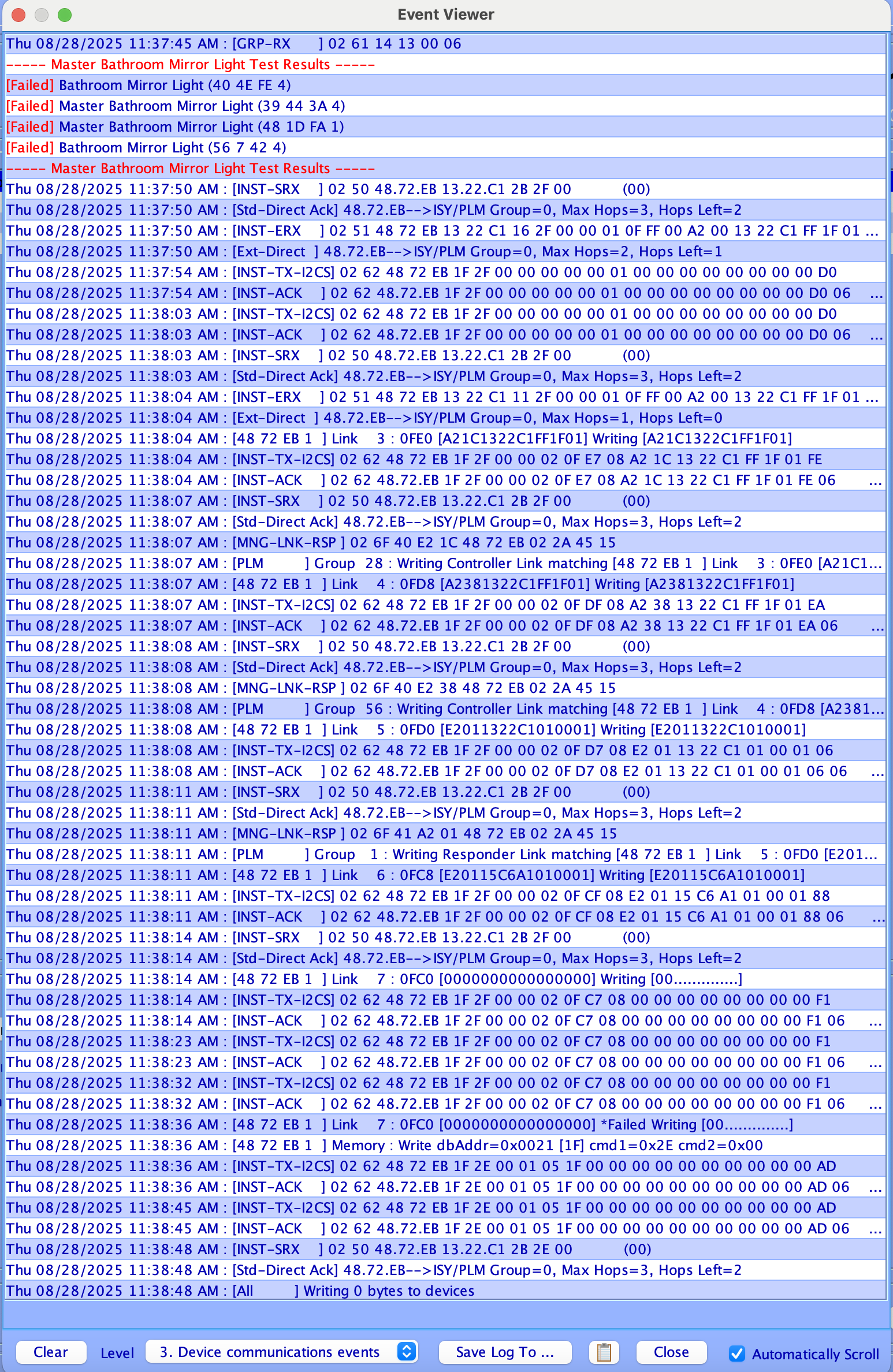

Either you have a communication issue between the devices and your PLM, i.e. noise on the powerline, or the link tables in your devices are corrupted.
First thing to try is right clicking on each of those devices and then click on restore device. That will rewrite the link tables that are stored in your controller to the devices. After the device restore run the scene test again to see if the issue has been corrected.
Post the results
How reliable is the scene test feature? I tested a scene twice and received back two completely different results. One where all devices in the scene failed, and one where all devices in the same scene succeeded.

The scene test is very reliable. It appears that your problem is/was caused by noise on the powerline.  How old is your PLM, the date code is the 4 digets on the plm sticker. Based on what you've described, It doesn't appear to be a PLM problem. If the PLM was failing it would effect more than just your scenes.
A UPS or other electronic devices can wreak havoc with the Insteon powerline signals. A good start is the Fillterlinc.
