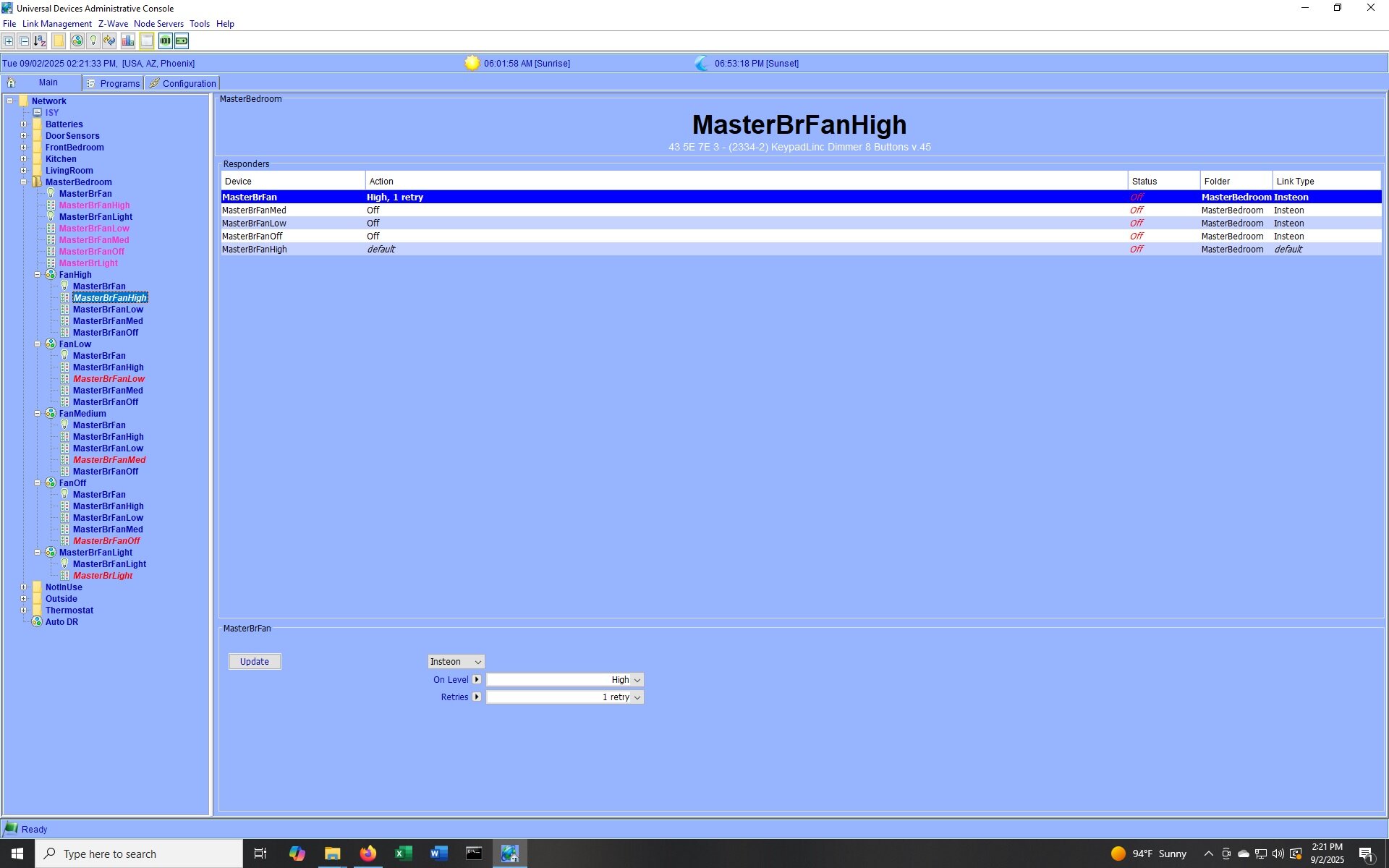

With that said check out the 5.x fan example which simplifies KPL Buttons, so you only need 3 (high, med, low) and only one can be lit at a given time, pressing the lit button will turn the fan off.  Then UD Mobile can control the fan module directly and the KPL Buttons will remain in sync.
https://wiki.universal-devices.com/ISY994i:INSTEON_Device:FanLinc-KPL_FanLinc_KeypadLinc_Configuration

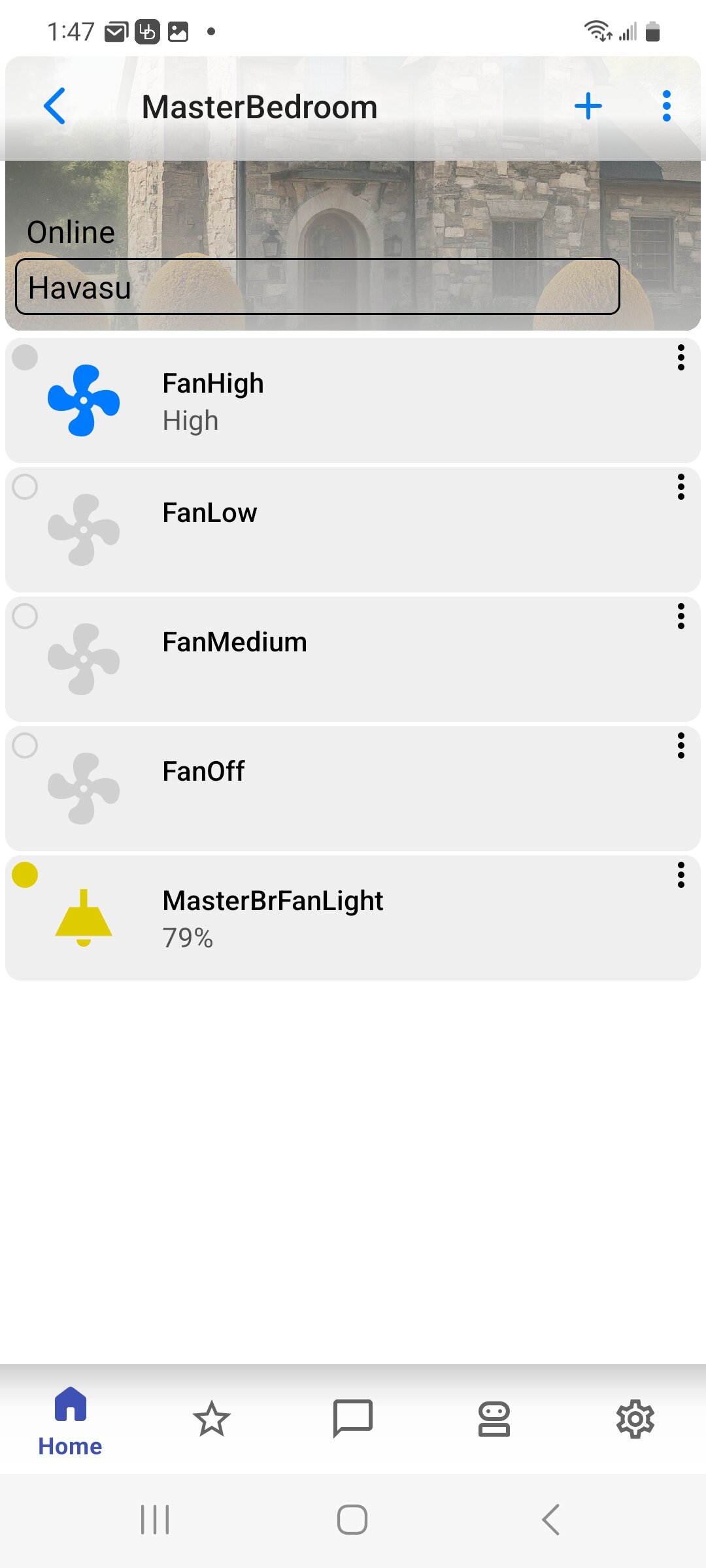

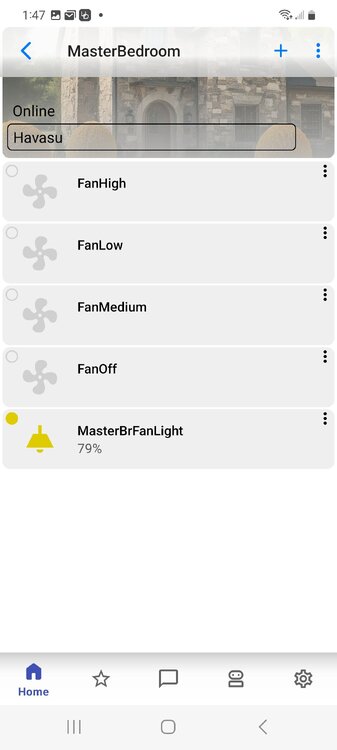

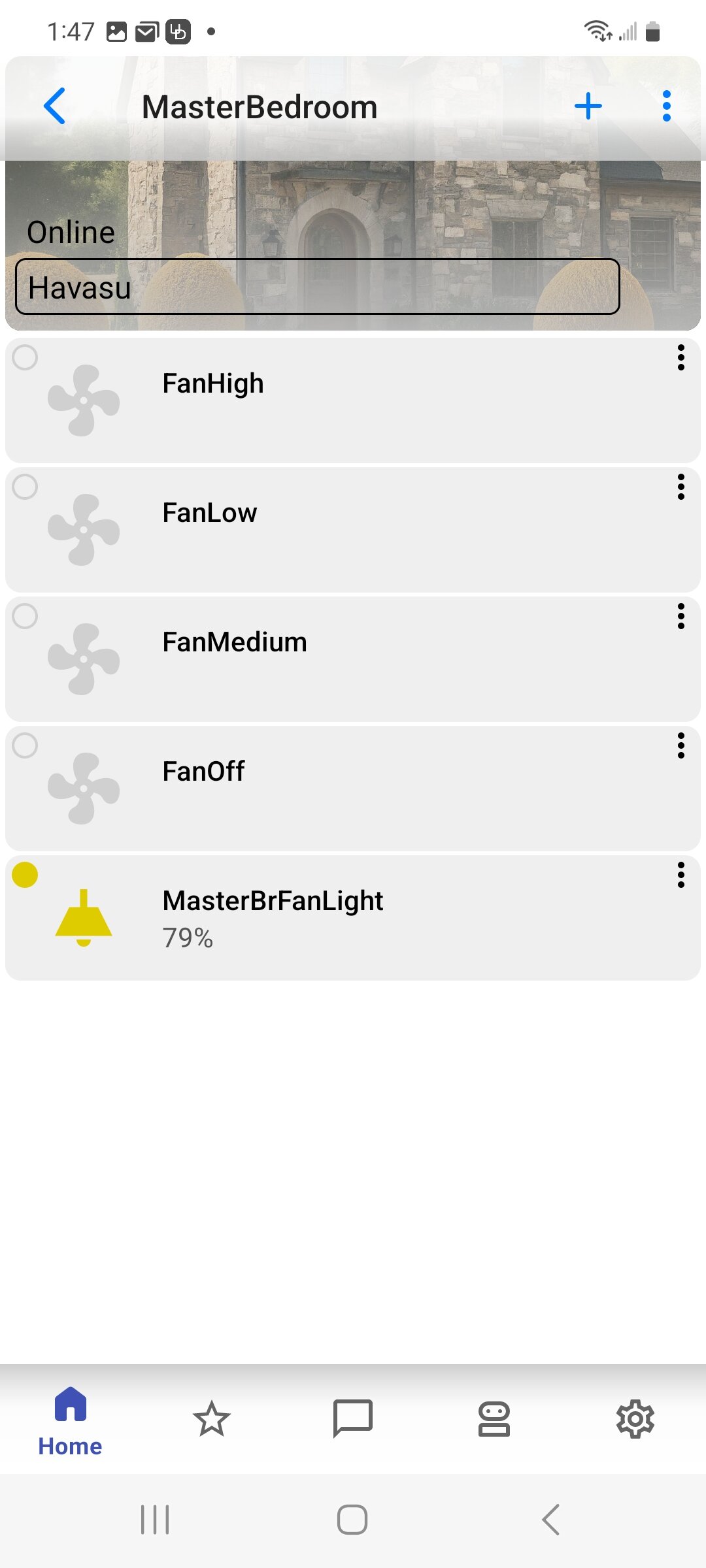

I've been doing that kind of thing using a virtual switch (with the Virtual plugin). It looks just like a switch in UD Mobile, but you can then have a program turn the virtual switch off, so that the next press is always to turn it on. There might be a slight delay before it turns off, but it will.
Here are a couple of screenshots.
