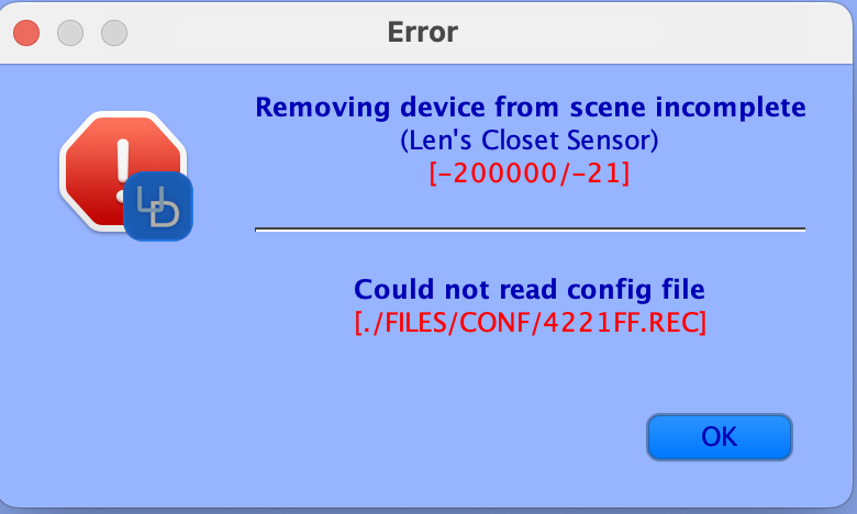

I have the 4814 Rev 2.6 Insteon Motion Sensor which has been working fine for many years.  Recently it has not been accepting scene modifications, so I tried viewing the links table to compare it to the PLM.  I got the following error:

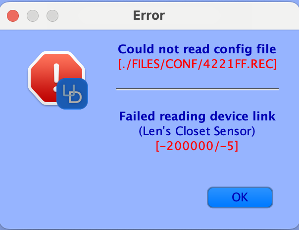

I tried removing the device and got this error:
Is it time to scrap it and buy a new motion sensor or is there a fix?  I tried a factory reset and that did not help.
