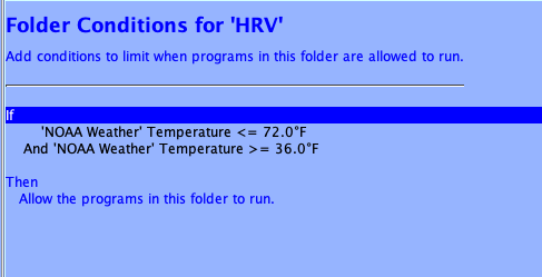

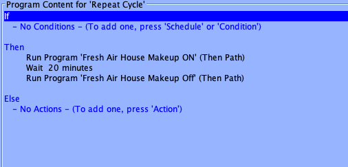

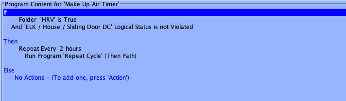

I have a repeat function to run every 2 hours to trigger make up air for my house. The issue I'm seeing is that the "repeat" function triggers before the defined 2 hours, on average once the subroutine that is called for repeat is finished it starts again within 5-10 min. Im unsure as to what I'm doing wrong. Ive moved a temperature parameter thinking that the every time NOAA Module pulled for temp that it was triggering but that doesn't seem to be the case as I moved that to make a folder true/false. slightly at whits end so any advice would be appreciated. below are some attached screenshots of my programs.

would that then trigger the IF statement to update every time the NOAA is pulled/updated? I assumed it would only trigger if the Folder changed states (true/false)?
Guessing based on that statement then I would need to set a variable for NOAA to update and then have the IF statement look at the variable?
