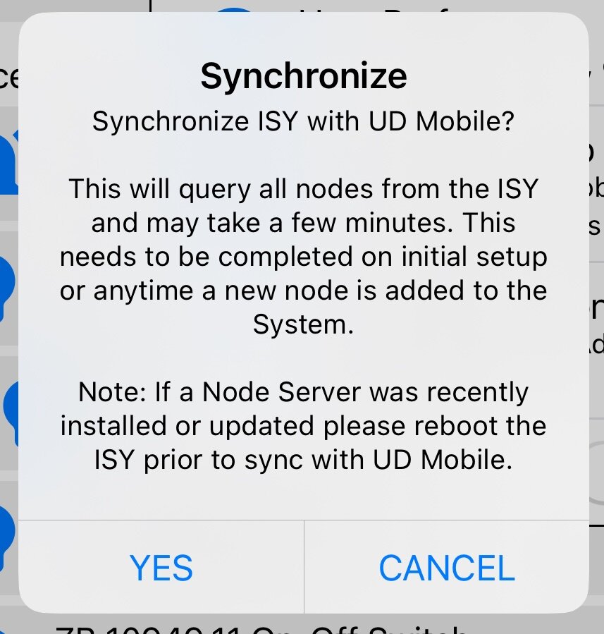

eisy.  Formatted Status values are published by eisy, so it's not app related.
Anytime a node server is installed a reboot is required before eisy will publish formatted values (this is written in the alert prior to synchronization). This was required in 994 due to lower processing/memory.  Sometimes a node server reinstall/update will trigger this requirement.
This requirement should finally be removed in firmware 6.0.0
If reboot does not correct the issue then there is another problem. The app will do a formatted status values lookup in dropdowns, so if dropdowns have formatted values and status does not (after reboot), then you may to open a ticket.
@Javi
Rebooted Eisy,
Opened UDM and went to controller, eisy, and said yes to sync (By the way, , my message is different than what you posted above)
Same problem. Only a number vs conditions showing in UDM, while conditions report correctly in the AC
